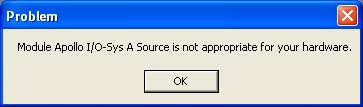

Post by Cochise »
What does this mean :-?
It pops up when I load Z-link I/Os since I've added a Pulsar II to the 2 Luna II.
Once I click OK, all seems to work the same...

Re: Module Apollo I/O-Sys A Source is not appropriate
Post by Cochise »
It happens when I load one of the two modules.
I was able to load them without this, before...
Post by Cochise »
Ok,
I just checked It happens when the Pulsar is set as 1st board tweaking the boardid in cset.ini.
Just wondering if I can work this way the same, or I've to avoid the Pulsar as 1st board.
Post by kylie »
I kinda guessed that your P2 has taken the place of board1 from the Luna.
wasn't that something that can be cured by recreating your default project to reflect the renumbering of the boards and their I/O?
-greetings, markus-
Post by Cochise »
There are no Z-link modules in the startup project, neither in the default.
There are Pulsar analog I/O at now, since I'm checking the balanced lines from the Plus plate of the board.
I use to load them when I need additional I/Os.
Which modules does the default project should contain?
Post by kylie »
all that you have in there now.
afair making a new project should be done to wipe all references that say your luna Z-Link I/O are located on board1.
I may be wrong here, but I somehow remember after changing the order of the cards it may be a good idea to make a new project from scratch.
-greetings, markus-
Post by Cochise »
Just tried all the things you suggest.
No error message if the Z-link modules are loaded with the default project, but if I remove one of the modules, or both and then reload it/them, I get the message again; even redoing the setup.
All is working, though.
Is it however better having the P2 as 1st board ( is this issue harmless 360°, i mean ) ?
Post by Cochise »
Ok, maybe I get it now.
I could set the startup project without Z-link and the default including them.
This way I could recall that project when I intend to work with the Lunabox...
Post by Cochise »
I solved this way:
My default project has no Z-link modules; It's loaded at startup since the command line in the autorun has no longer the -s.
The startup project has Z-link modules, and I recall it from the file menu when Lunabox I/Os are needed.
