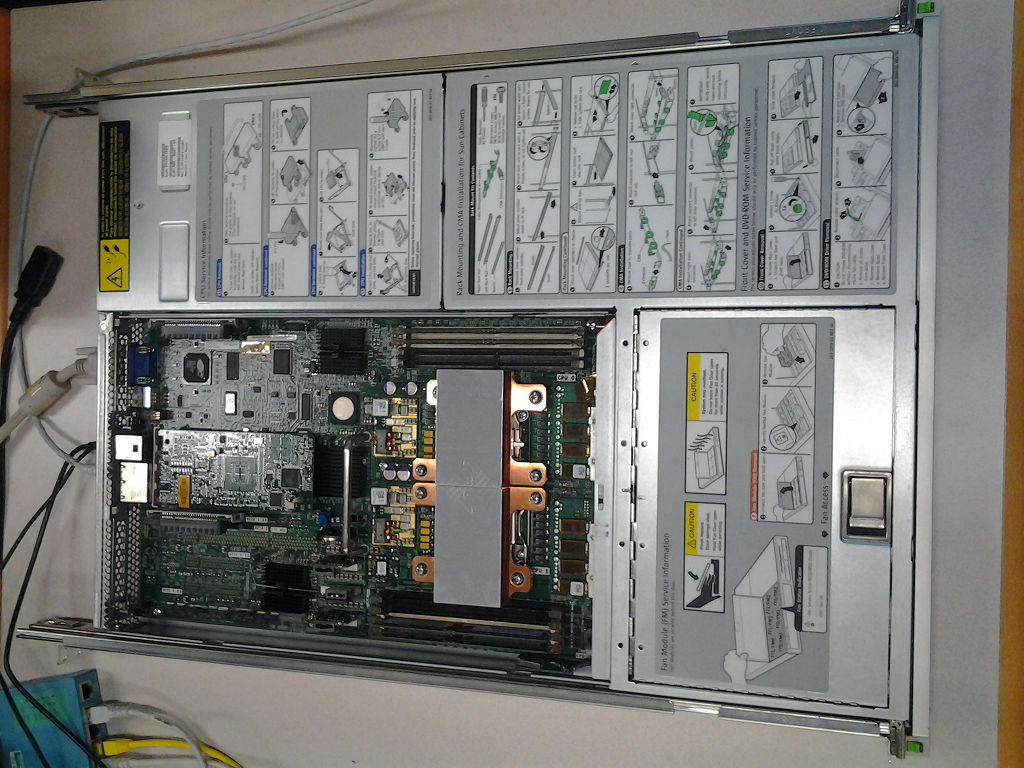

anyone know where to get a smaller metal plate for the xite pci card?
see my probl. -->

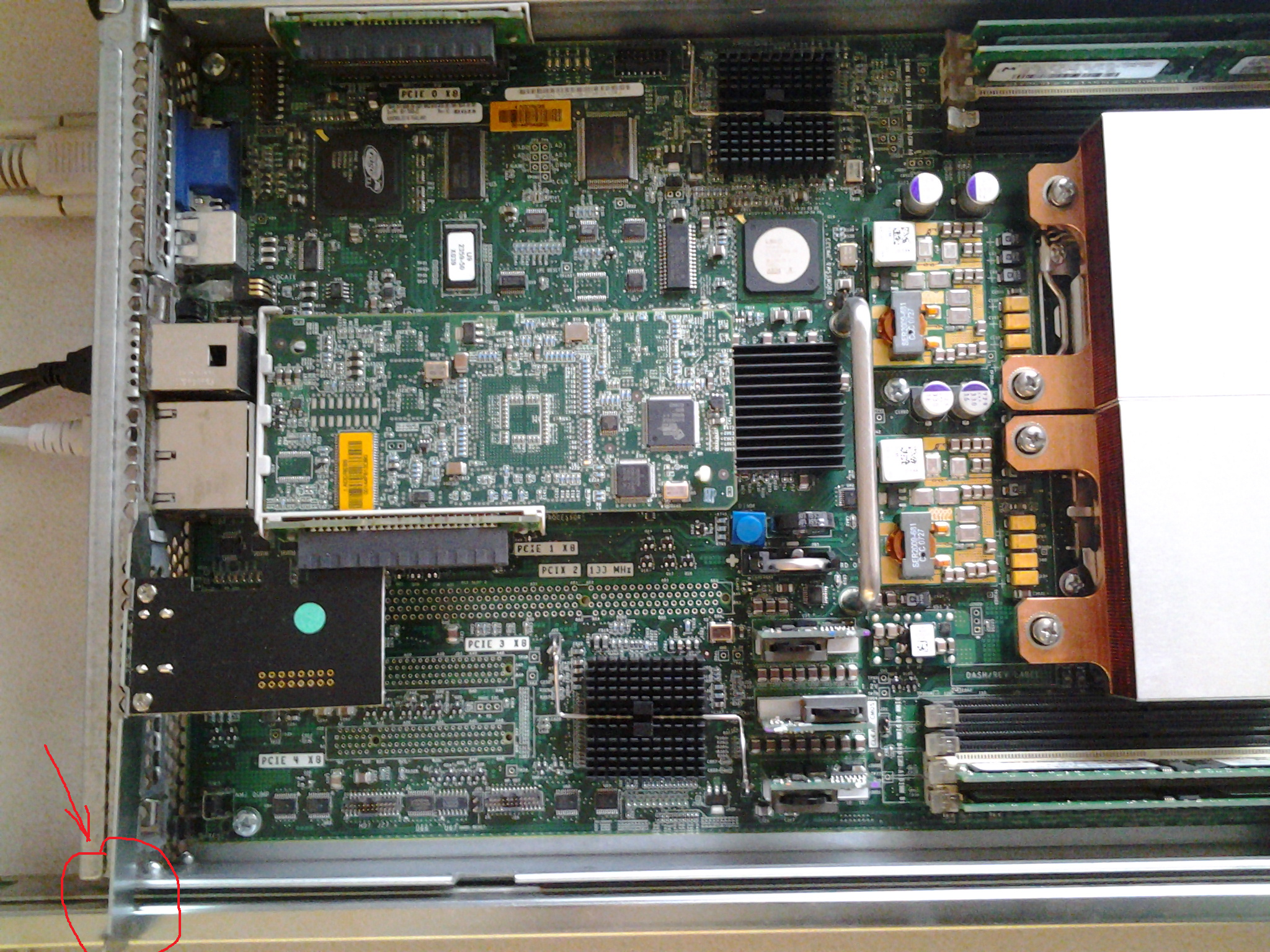

have a new toy_
sunfire vibes
sunfire vibes
- 2013-12-13 15.28.45_b.png (1.64 MiB) Viewed 3046 times
Re: metal plate

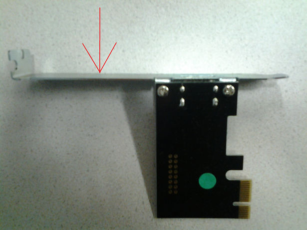

the metal plate on the pcicard is too long;
i screw them up . . but then the card just holds with its connection to the pcislot
a little bit stabilized with the cable;
o.k. for testing but i need a smaller metal plate to put on the card

Yes, but one challenge is, that you do not just need a low profile plate. You need a low profile plate with a HDMI port - and the screw holes for the card in the exact same relative places. That is the reason I recommend a smith who will bend your plate, make the whole for the chassis mount and cut the excessive part of. Or you could do it yourself. Maybe you can ask Sonic Core to provide you with a plate without card - and then butcher that plate, so you still have one in normal length. I imagine it will be hard to find a standard low profile plate which will fit with your Xite card.

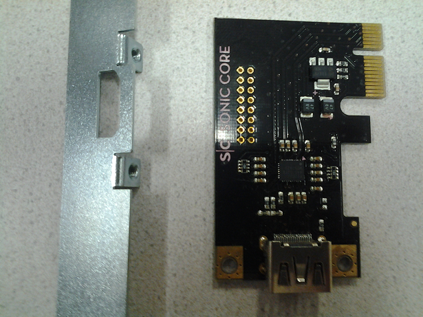

Re: metal plate
the connector is not connected with the plate itself;
there is just a hohle in the plate;
thought there is a standart for hdmiout-plate-small
yes cutting the plate is a way;
i would prefer srewing to another plate you know

@jksuperstar
yes such a thing but i cant find a fitting to sccardmounting one;

i think you just need to remake the bracket. cut, snip, maybe solder/braze done....
