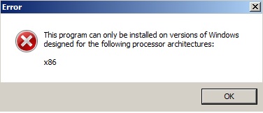

Very strange.. I'm trying to install mod IV on my 64bit pc with xite-1 but when I run the setup, I get a message wich says something like : 'this setup is for 32bit system' !
Help ! Thanks !

GaryB has it unzipped, so you can do the install. Contact him.
However, I've still not been able to get the tape delay to work in x64. Others here sent me some files that were supposed fixes, but they didn't change my problems (no delay and mod IV complaining about WDM Missing). My messages to support at Sonic Core are unanswered about this yet..........

I made like explain here :
http://forums.planetz.com/viewtopic.php ... 86#p269697
and it seems to work...
I believe SC should give us a working 64bit setup !
I had to reboot my pc on W32bit , install mod IV and copy all the files to the 64bit version ! I am exhausted !

I heard back from Ralf, who made things all well. I am a happy mutha fucka ucka ucka ucka ucka ucka....
I'm copying his email here. The new tapedelay64.sys sent me in loops...
yes, you are right. The installer does not work on 64 Bit.
64 Bit installation Modular IV:
If you are using Scope 64 Bit, please download the files from here:
ftp://sonic-core.net/software/scope5/pl ... ular%20IV/
Unpack the zip and copy the files in their:
ModularIV/Additionals -> C:\Program Files\SCOPE XITE\Additionals
ModularIV/Devices -> C:\Program Files\SCOPE XITE\Devices
ModularIV/Modular Modular -> C:\Program Files\SCOPE XITE\Modular Modules
ModularIV/Sys -> C:\Program Files\SCOPE XITE\App/Sys
Create a folder: //Devices/Modular4/Patches
Copy the patches Patches -> C:\Program Files\SCOPE XITE\Devices\Modular4\Patches
Dezip and copy the files over the existing installation.
We have also packed one demo patch and a manual. Please create a folder //Devices/Modular4/Patches
and copy the DeeKey.dev to it and the preset file in the Preset folder.
Important is the sys file for the delay. It has to be the version for 64 Bit.
Hope this helps,
Ralf
