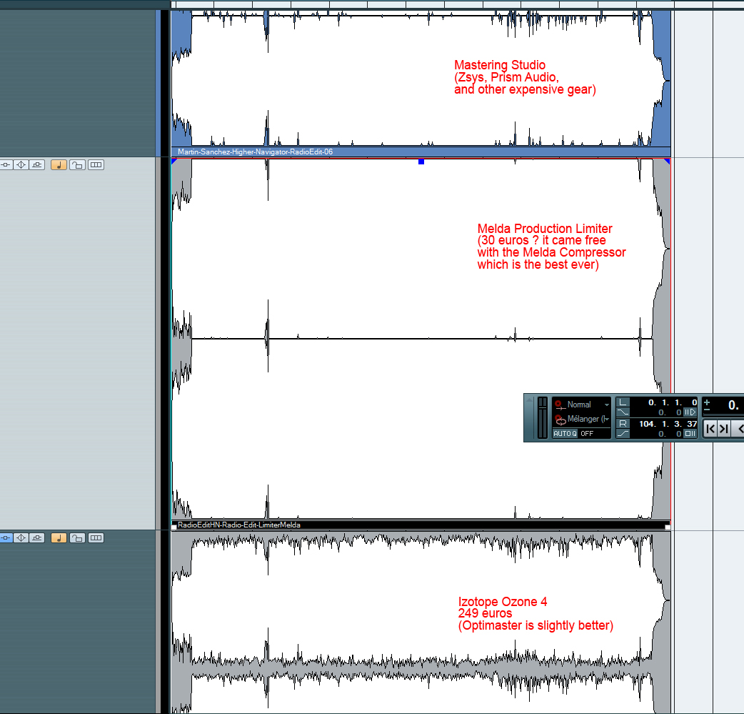

Hi ALl,
Just thought I would share my findings and may be hear from your own.
Some of you know that I am releasing a single (nothing too fantastic, but I try to do it right for the future). So yesterday , the guys who manage relationship with radios asked me if I wanted to boost my version as well as the dance versions they had been doing. My version comes from an expensive mastering studio in Paris (they have probably more than 100.000 euros of gear... like speakers at 22.000 euros (each!!) etc :o ..
But yes, it could be boosted , but it is hard to avoid distortion.
What i needed is just to cut a few peaks, more than what they could achieve in the mastering studios.
What they are asking for is a "re-master" (boost levels of the studio mastering).
1 - I began running my single through Optimaster: very good boost of volumes, but too slow compressors let micro peak pass through ( I didn't try the limiter, I have one DSP limiter that is better ;-) ...).
2 - Downloaded Izotope Ozone 4 Demo, and the plugin is pleasing, but a little bit behind Optimaster.... no improvement on compressors attacks. Optimaster does a better job in respecting the original shapes and volumes, but micro-peaks still pass through, forbiding a full normalization (you end up with more compressed dynamics, but a loss of volume, so it has to be re-worked a bit after an optimaster treatment). Izotope is exactly the same, but in my iopinion, it performs less than optimaster (look at the izotope shape below, which is nomalized at 0 dB... I don't have the optimaster pic, but it is much bbetter than izotope in this field. With Optimaster, all is more contained, there is not such big dropdowns in volumes, peaks are more rounded.)..
3 - Loaded Melda's Limiter..... which came free when I bought their compressor at 30 euros... and at last, it is what I wanted to get. Hard and fast clipping.
4 - I didn't try LimFat, but I know it would have done a good job in hard clipping, but not as well as Melda's plugins, which generate no distortion at such clipping levels, and also the thing is that I didn't want to go through Scope again due to the very tight schedule and no time to think too much (1 hour to do 4 tracks....) ... that's why I finally chose the vst way.
A picture speaks for itself, even though it is comparing different mix of lilmiting/compressing algorythm..
But in the same time, it is comparing two Mastering tools (Izotope and Optimaster) with an almost free limiter....
NB: There is a vinco too, but that was "pre-master-studio" (it is alsready in there).
ps: it is the mastering from the studio that is "re-mastered" (re-limited?), i don't think i would have reached such a rectangular wave without going to this mastering studio first (i've tested a couple of them, not all of them acheive good clipping/levelling, not without distortion at least).....
Good luck, and thanks to share experiences.

radios, clubs, promotion... everybody except the musicans and sound/masters engineers ;-)
beleive me, between my original song and the final masters, there is world or two....
even between the two masters studios, there is a huge difference in everything.
ps: don't be fooled by the pics, if you zoom in there is still something like -7/-8 dB RMS (average)...

The pics I posted, the most "compressed" wave has -7.9 dB average RMS, not far from the 8dB dynamic advised in the article: it is already way too compressed and doesn't have lots of space. What comes from home doesn't usually pass the 9dB. I am sure none of the Michael Jackson song wave posted above has lower values than -11/-10 dB Rms avarage... they can crop the peaks a bit more :-) Just to point out that -8dB is already a very compressed track in terms of dynamics, I never received something so compressed form a mastering studio personnally.
Thanks for the advice about Elephant. Here, Optimaster and multibands in general could not be used, as the main interest of mastering is not compression, that you can do yourself, but the Equalizing that should be kept when you like it (I don't trust my room enough to rework equalization that was made with speakers which value is 44.000 euros a pair (big B&W speakers) :-) )
