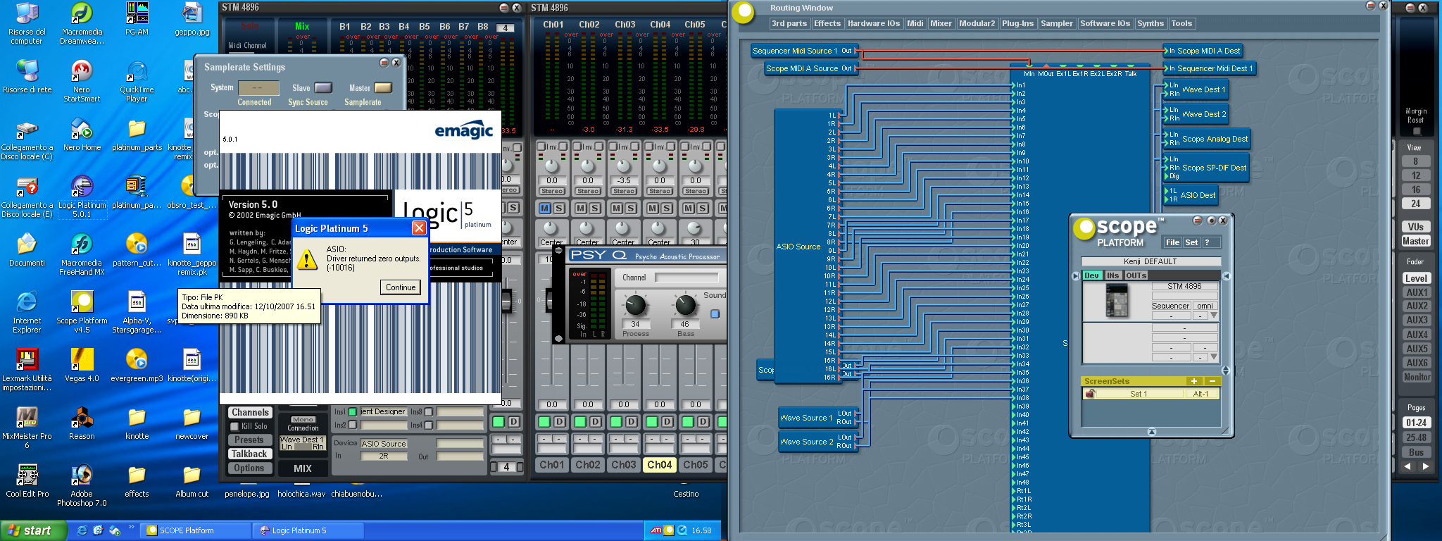

i took a screenshot of my desktop whilst is happaning this error
- bega.jpg (863.49 KiB) Viewed 3260 times
referring to your screenshot:
whatever errormessage the program reports is completely meaningless
the only thing that matters is that there's no samplerate in the respective Scope dialog.
in that state the system is unable to do any 'reasonable' communication at all and error messages of the host program are rather arbitrary.

don't bother about the sequencer - you got to have that sample rate window constantly show a number, everything else comes after that.
Without stable clock no other software will be able to communicate with the card - it's really that simple
Listen to empty channels in the mixer (or feed it something if you prefer) - and watch the sample rate, as the dropouts can appear even in > 1 minute intervals

for cleanup of the situation:
