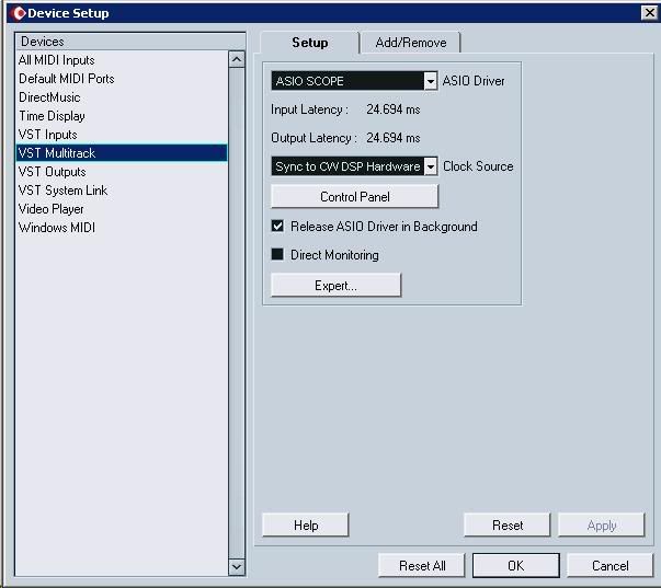

make sure you have no conflict between the card and other cards.
make sure that your driver version is 1.50.10.0. try updating the driver in device manager.
make sure when you load cubase that Scope ASIO is selected

You have to change the ASIO-Settings in Cubase.
It´s like that:
Cubase scanns the computer and finds different ASIO-drivers.
And of course it takes the most common one.
You have to find the menue where you ca set up your drivers and change to ASIO Scope.
Sorry, but I don´t know where to find that in cubase... I´m on Logic, Live and ProTools.
Hope it helps!
