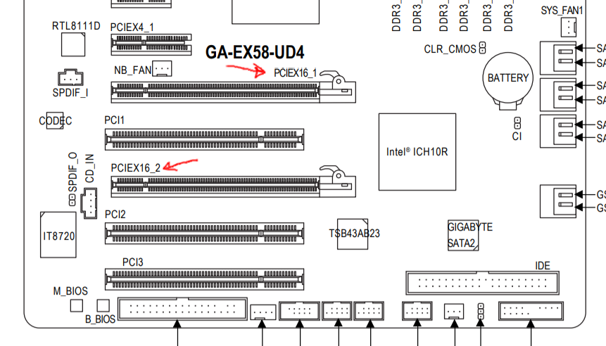

last last question!
can I mount the extender PCI-X "motherboard" on my PCI-EX16 slots?? they are larger than the connector on the extender board... it fits, but will it work?
the small PCI-EX4 is used by the graphic card...

bosone wrote: Tue Jul 02, 2019 12:52 pm last last question!
Hello Bosone . I asked a friend of mine and said there should be no problem, on my case I used another graphics card that required a bigger slot, so I had the small one free ( had to use an extension though cause it was blocked by the cards' fans case). So I cannot say 100% it will work.. we will have to trust on the standard implementation of the Pci-e :D .
Snoopy4ever
