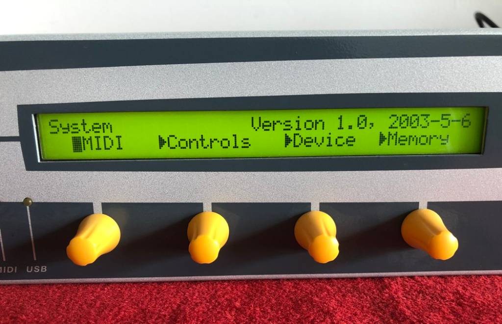

What´s the system software version number on your Noah ?
Go to system page on Noah frontpanel and have a look ...
It should read a higher version !
