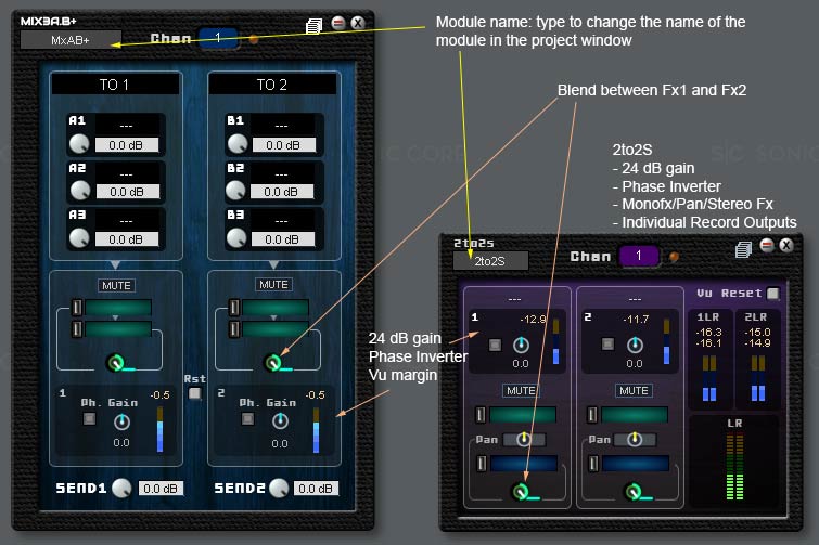

The devices in the attached zip are used to manage signals when using external mono effects such as spring reverbs or guitar pedals.
>>> Spring reverb tank on Scope/Xite https://www.forums.scopeusers.com/viewtopic.php?t=37305
Both devices are MIDI and preset able.
You can change the name of the project module by typing under the device name at the top-left of the panel.
Also found here: https://spacef-devices.com/free-downloads/
2to2S
- Used as a "return utility" from 2 external mono effects. it includes 24dB gain, phase invert and insert Fx (1 mono, 1 stsreo).
- The "Blend" controls allow to crossfade between "Fx 1 post-pan" or "post Fx2": for example, if you have an Eq and a Phaser, you will crossfade between "Eq+Pan" or "Eq+Pan+Phaser"
Outputs:
- LR output is the mix, to send to a scope mixer for monitoring
- 1L / 1R outputs channel 1, to send to asio for recording
- 2L / 2R outputs channel 2, to send to asio for recording
Mix AB+
Used to send signals to 2 external mono effects.
3 inputs per channel allow to plug sources once for all (for example, an asio source, a wave source, an aux send from a mixer).
You can use mono insert FXs and crossfade between "post Fx1" and "Post Fx 2" : if you have an Eq and a delay, you will crossfade between "Eq only" and "Eq+Delay".
You can name all sources (A1, A2 etc).
ADDED TO THE PACK
- 1 Send (single channel of MixAB+)
- 2to2G (like 2to2S with special Gate)
Enjoy !
Mix AB+ | 2to2S | 1send | 2to2 G
- Send and Return Utilities.zip
- (1.74 MiB) Downloaded 344 times

Re: Mix AB+ | 2to2S | 1send
Added "1-send.dev", a single-channel version of MxAB+ , with the same functions.
Download in the first post (1send.zip)
Tip: the crossfader can be used to add a dry/wet function to the second insert effect. Useful for effects that do not have dry/wet, such as filters, autowah...
