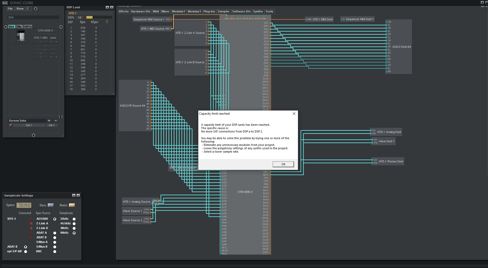

But I can't find a solution, I've got an A16 ultra, on scope 5.1 I could do 16 simultaneous tracks, but my scope project didn't work at all on scope 7, so I use the stm buses, but I'm limited to 8, which didn't cause me any problems until now, but now I have to increase the number of tracks.

Yes, my scope 5.1 project was like that, but on the 7, I get a "capacity limit reached" when I connect the last output.
But if I connect the last output to a bus, I don't get an error message.

96k uses double resources, and some of the dsp resources(connections between dsps especially), are quite limited. this has nothing to do with the number of dsps. the order devices are loaded in =can make a big difference, as there can be quite a bit of dsp sharing with bigger devices.
