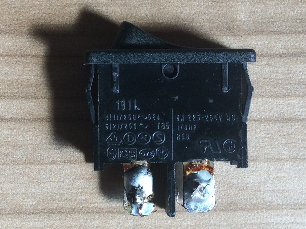

The switch from my A16:
Size is 22.6mm x 6.6mm with a kind of integrated plastic spring to keep it in position.
Anything with less than 23mm height and 6.5mm width will fit through the front panel slot.
It‘s a regular light bulb switch, nothing particular.

the ultra has a different switch.
Posts: 8455
Re: Sonic Core A16 problem
oops, I read a A16 with AC PSU... and thought of the blue one, but re-thinking it... the A16U is also fed by AC :oops: :D

Yeah, that's definitely a different switch. it's a push-in switch (there's probably a technical term for that)
