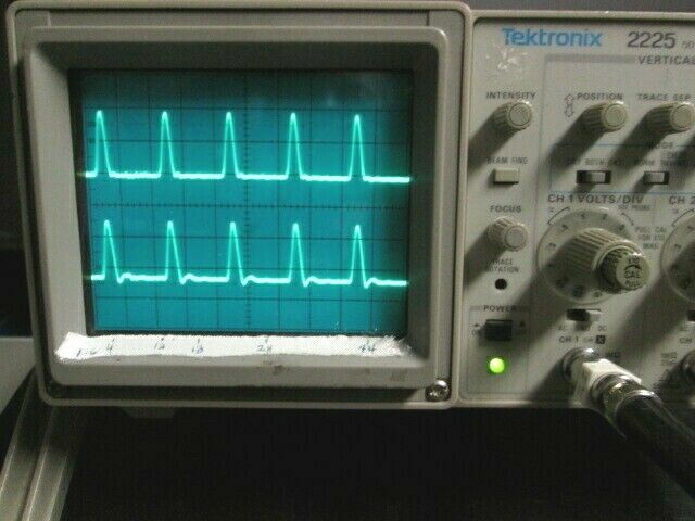

Re: Oscilloscope for ASIO windows ?
that was just a picture, but you can find a real one for $200.
It has been a while since I looked, even on ebay that pricing is accurate
