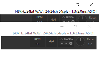

Rearoute doesn't add a lot of latency, this screenshot is a comparison between a session of Reaper connected straight to the hardware ASIO driver and another session of Reaper connected over Rearoute driver.
As we can see, Rearoute only added 0.6 ms on the total in/out roundtrip.
