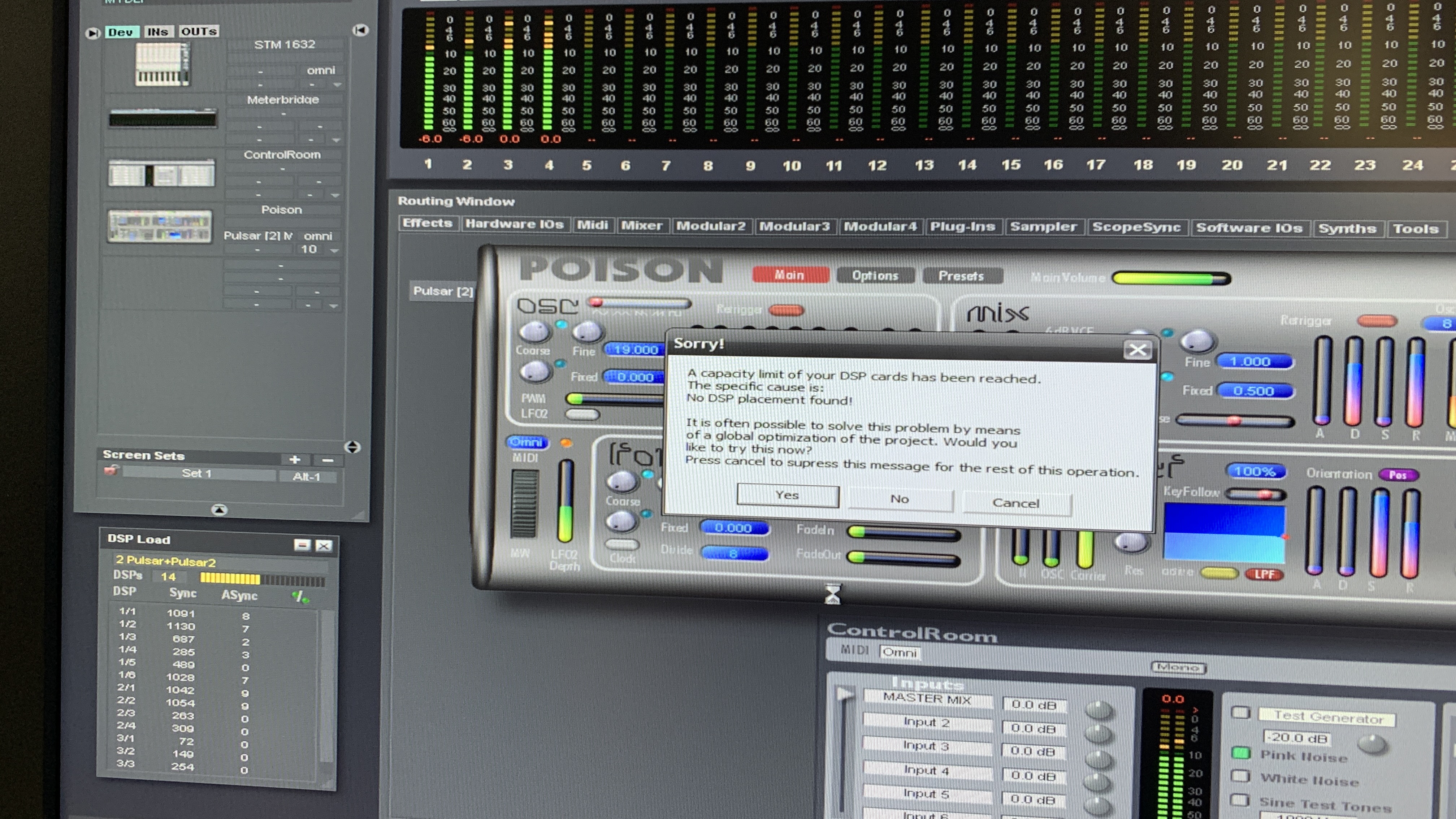

Here is the message I am getting. It just happened now with only 1 poison FM running, 10 voice, and this message came up when I clicked LOAD FILTER ON DSP
and Im running at 44.1

Voice counts are the first thing to look at, if you load a synth with a voice count of say 8 it can take considerably more resources than you might expect. Also be aware that the internal resources for each DSP chip aren't just an empty bucket to be filled, but each dsp chip might have all usable resources for one function utilized and so give this message, while a different simpler device might still load onto that dsp chip.

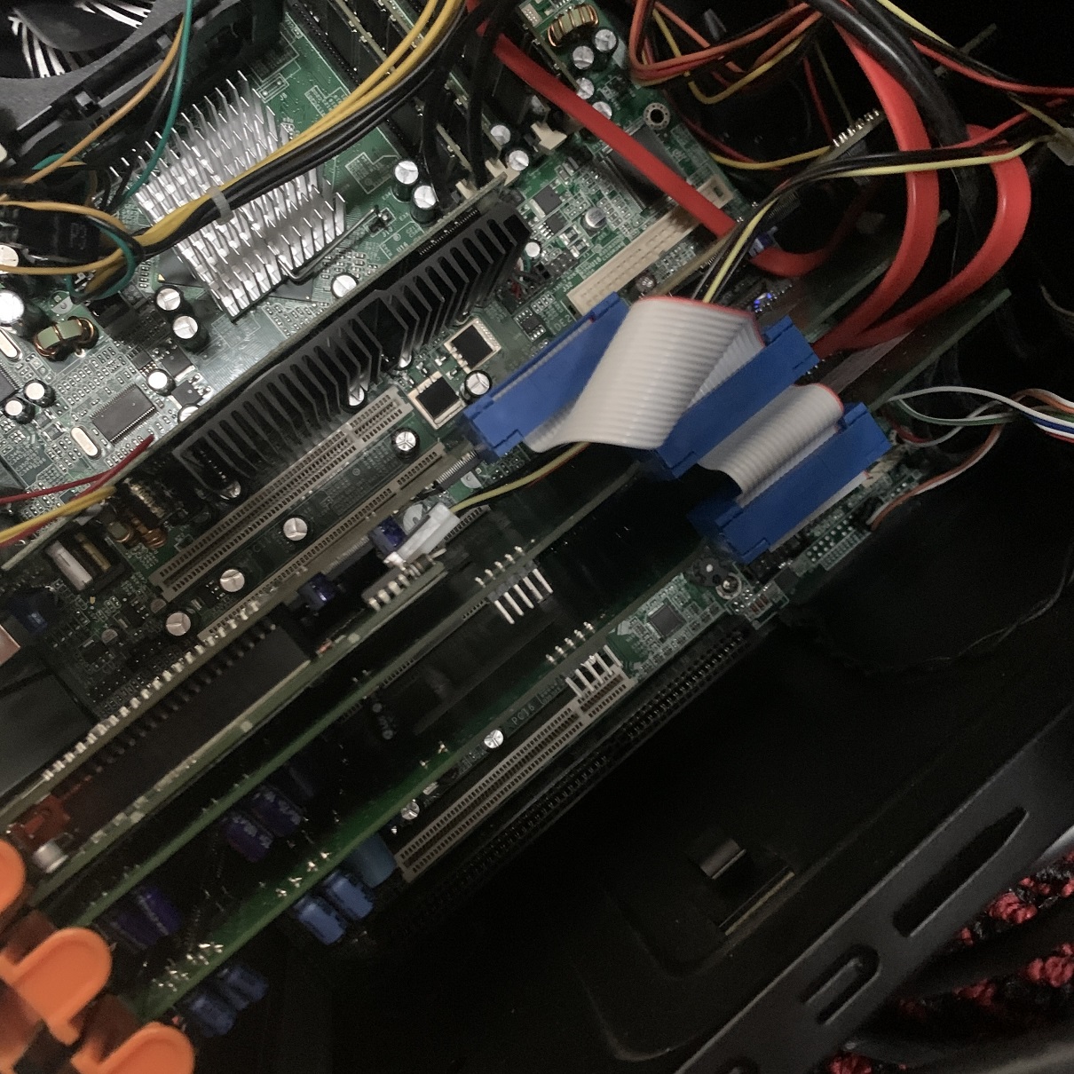

It is definitely no STDM cables between cards.
Posts: 23414
Re: Out of DSP message, even though there is plenty?
that is the problem. see this Scoperise article:
https://www.scopeusers.com/ScopeRise/is ... m_mast.htm

I definitely followed the manual closely on how to connect them all up, and I was running just two headers of the STDM for weeks with no issue. I even made another cable yesterday, this is how I have it:
But yes maybe I should try to run the Pulsar2 by itself...

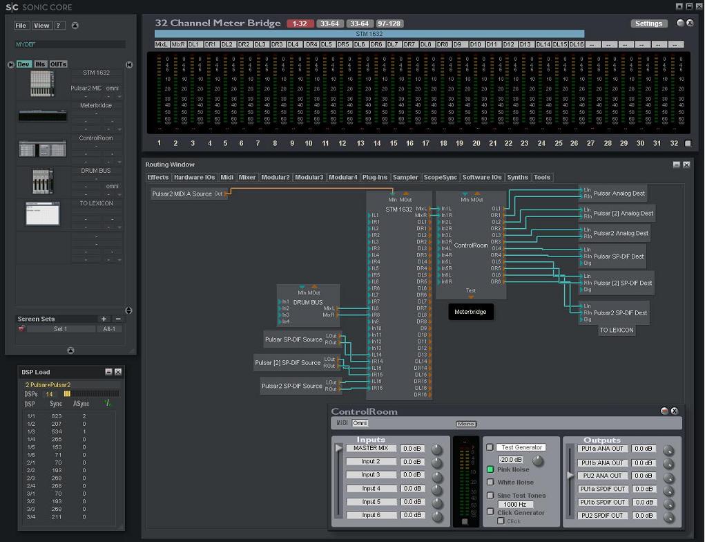

Valis, what do you mean by "route in the routing window" and not a mixer. You just have everything going direct form ins to outs, or a synth going right to an output?
I use a large mixer yes, and a control room switcher thing, since I have all the outs going to various external rack gear or my main recording PC. So I can quickly go back and forth via a switch in the control room module (depending if I am tracking, mastering or just capturing sounds/bits), from analog outs to spif then adat, etc etc. I also like having aux sends on the mixer, as well as master inserts for scope effects.
Same with inputs, I have various stuff going into scope that I like having hooked up all the time for easy recall. With all the routing and mixers, and control room etc it doesnt seem to take up that much DSP, I believe just about 3 bars or so on the DSP meter thing.

current routing:
Posts: 7760
Yes, I route directly between devices & i/o's. I do understand why you use the mixer, I used to do that as well. When I worked with Assaf on Flexor, I learned a lot about maximizing my use of resources in Scope for what I wanted it for, things that can be done elsewhere are. But noone wants to dictate YOUR workflow, just giving hints since (as GaryB points out) sometimes resources are limited by the size of the board and/or how direct a path is between dsp's when certain resources are no longer available locally.
As flexible as Scope is, you can use it in many ways. So rather than worrying about what the best way is for even me, I have learned multiple workflows and just deploy what works best at any given time. Like you, I have a variety of external gear and lots of i/o in my space. So much so, that most of my i/o to Scope is ADAT/AES/Spdif now. It connects to my main board through one of my card's analog i/os on the output, and the input is fed off of a bus on my board. The other card (I use 2) is fed from my sends and goes back to a return. That effectively gives me a solid path to bus process audio, return audio, feed any synth stack or etc, and I can also do an fx chain on the send/return (or return another stereo pair etc). The reality for me is that most things are going to get fed back via ADAT and bounced down eventually, so I started working in this manner.
What that does is effectively give me a solid signal chain that does 1 thing in the end, whether it's a full fat synth stack or processing something external to record it, etc.
