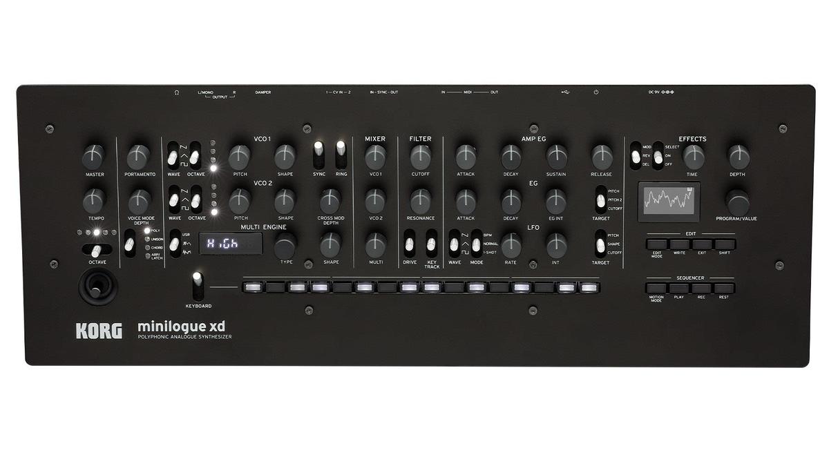

Hey !
It's been approx.15 years since i last time used hardware synth.
Few months ago i have purchased Korg Minilogue XD module.
It has USB Midi output to computer.
Connection is pretty simple.
In Cubase Artist 11 is recognized normally and i can also use editor for Minilogue and record knobs movement in editor and so.
I like that part.
What i have noticed is , while Minilogue is in slave mode, I can hear some sync drop outs in arp section, also built-in effects are here and there little out of sync.
While not in slave mode and use module's BPM is little better, but still.
Is there any difference in stability while connecting module thru MIDI ports to, in my case, to Luna II midi IN or ?
Can i also record knob movements thru MIDI port ?
Do you have any experiences with synths which they have USB Midi connections ?
Thanks for any kind of tip, suggestion, experiences :)

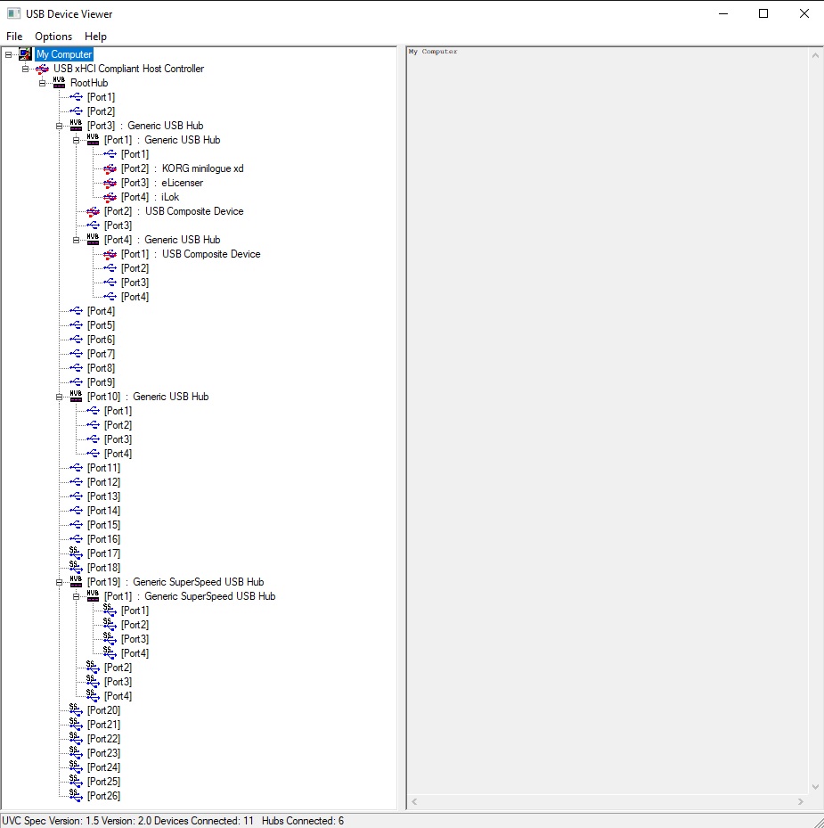

Give us a screenshot of your USB device tree, with the section containing the Minilogue fully expanded:
https://www.uwe-sieber.de/usbtreeview_e.html

USB Device Viewer
Posts: 7750
Re: Connecting hardware gear
Long story short, you need to keep your iLok/eLicensers on the hub and move your Korg over to a dedicated port, or a second hub which you'll use only with midi devices.
You might find you still have these timing issues, if there's an issue with the Korg's USB implementation, but it's also possible that some audio applications access the midi ports through different API's as well. I would need to see a screenshot of your audio application or DAW, along with what you can configure in your options or preferences to enable midi in & out ports.

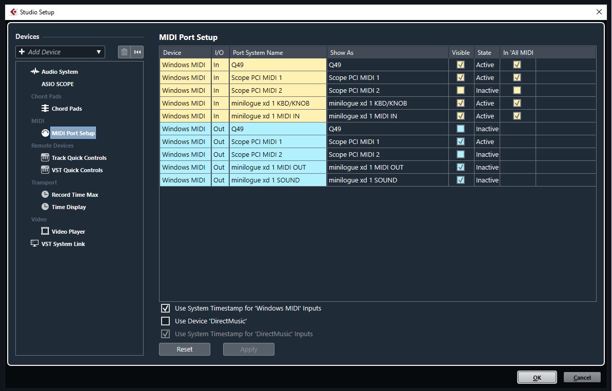

Lastly, it is possible with some keyboards & etc to address their physical midi DIN port as well as the USB port, either connected to the same DAW software or perhaps to send midi on USB from your DAW, but attach a keyboard controller directly to the Korg itself and play it that way. So, you might experiment with using the USB port for midi clock and control messages, while sending notes along the midi out from your Scope cards. Or vice versa...until it syncs stably.
Feel free to post your DAW's options page for enabling midi devices if you'd like. I can also drill further into discussing the USB stuff if anyone cares.

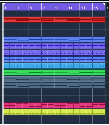

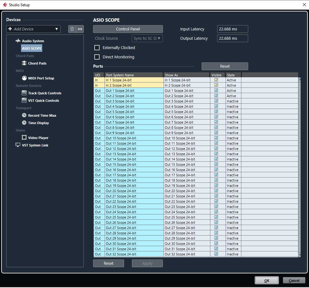

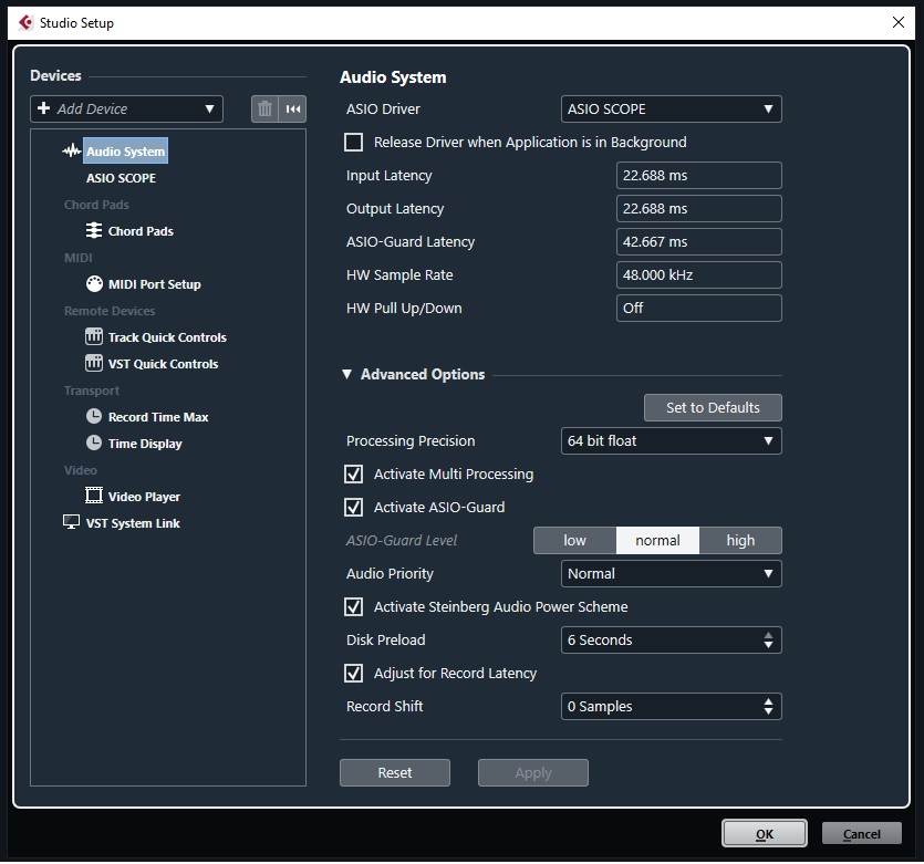

Here is my Cubase Artist 11 studio setup.
Working with VST's instruments/effects and Scope plugins is very stable.

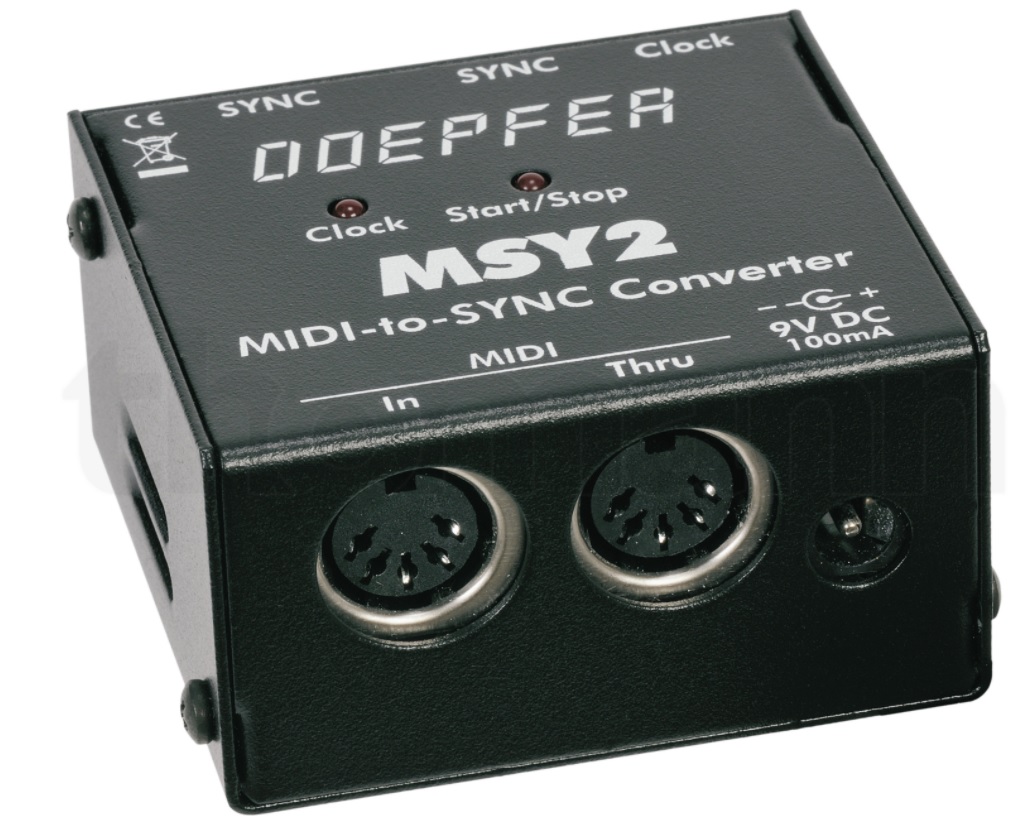

valis wrote: Fri Jan 29, 2021 6:30 am The other solution is to use a dedicated midi input for clock/sync, and of course there's a world of hardware devices geared towards extracting and injecting midi clock in a variety of ways.
https://www.thomann.de/gb/doepfer_msy2.htm
It's quite cheap, but if this can be good enough, for what i need ? :)
Posts: 7750
The issues you're noting with pitch 'vibrato' type effect is due to fluctuations in midi clock, which is 100% normal. If you send a dense array of other messages (lots of midi CC's etc) you'l note this gets worse, and is due to how the midi datastream works with the limited bandwidth of a midi port. This is why I suggested (if you must sync to an external clock) using one input for clock and the other midi input for all other data is a typical workaround, if possible on a given module or setup of course. Internal clock is still preferable.
I'm not sure if you're saying the vibrato effect still occurs even when set to internal sync? Then this would be a different issue, perhaps something sending pitchbend data that's showing up on that module?
The clock converter you linked above shouldn't be necessary in your situation, though if Minilogue supports CV / Gate style messaging and the Eurorack style sync clock, then it might well be useful in other ways. I am not familiar enough with that Korg unit to know offhand...

valis wrote: Fri Jan 29, 2021 8:37 am The clock converter you linked above shouldn't be necessary in your situation, though if Minilogue supports CV / Gate style messaging and the Eurorack style sync clock, then it might well be useful in other ways. I am not familiar enough with that Korg unit to know offhand...
I think it does...
Audio Sync for all studio/live requirements with connection to ...
You can also expand polyphony to 8 voices, connecting 2 modules together.

Posts: 7750
If the clock is fluctuating it would start with the project (is there a tempo automation change somewhere?). The the port comes next. The USB midi wouldn't be limited by baud rate, at least due to transport issues (the usb cable has oodles of bandwidth compared to MIDI DIN-5). But it can be affected by other devices, so we started there based off the info given in first post.
If you're sending a LOT of event data, timing might be affected by the way the internal engine handles events (you'd think this would be sorted by the dev team though).
Sometimes midi problems are also due to another device sending data and your track listening to all inputs, or something like having biderectional midi data going to & from the device. This can be a loop, which would be bad, but even HUI type data sent to keep encoder positions up to date can bog things down sometimes.
hard to say exactly from the info given so far, so just giving pointers =]
