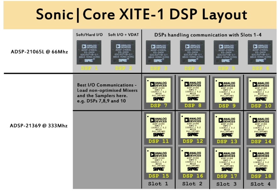

The main benefit is that the XITE Sharc chips are a faster, later model than the ones on PCI boards so you get more bang for your buck when paying for DSP power. The newer chips are in the order of at least 5 times more powerful than the old chips. And you still get 6 of the old chips for compatibility :
XITE-chips
XITE-chips
And you get the bandwidth benefit of PCIe on the XITE compared to legacy PCI with the cards.

I have some 15 DSP cards and Xite in parallel. Migrating project is quite simple: Just reconnect the IO to the Xite-ports and for the SC-devices always point to the ... X-Version of the device.
PCIcards are not replaceable if very much Adat-ports are needed, as you can add more IO by adding cards.
For all other purposes, Xite has more power and the more modern interfacing.

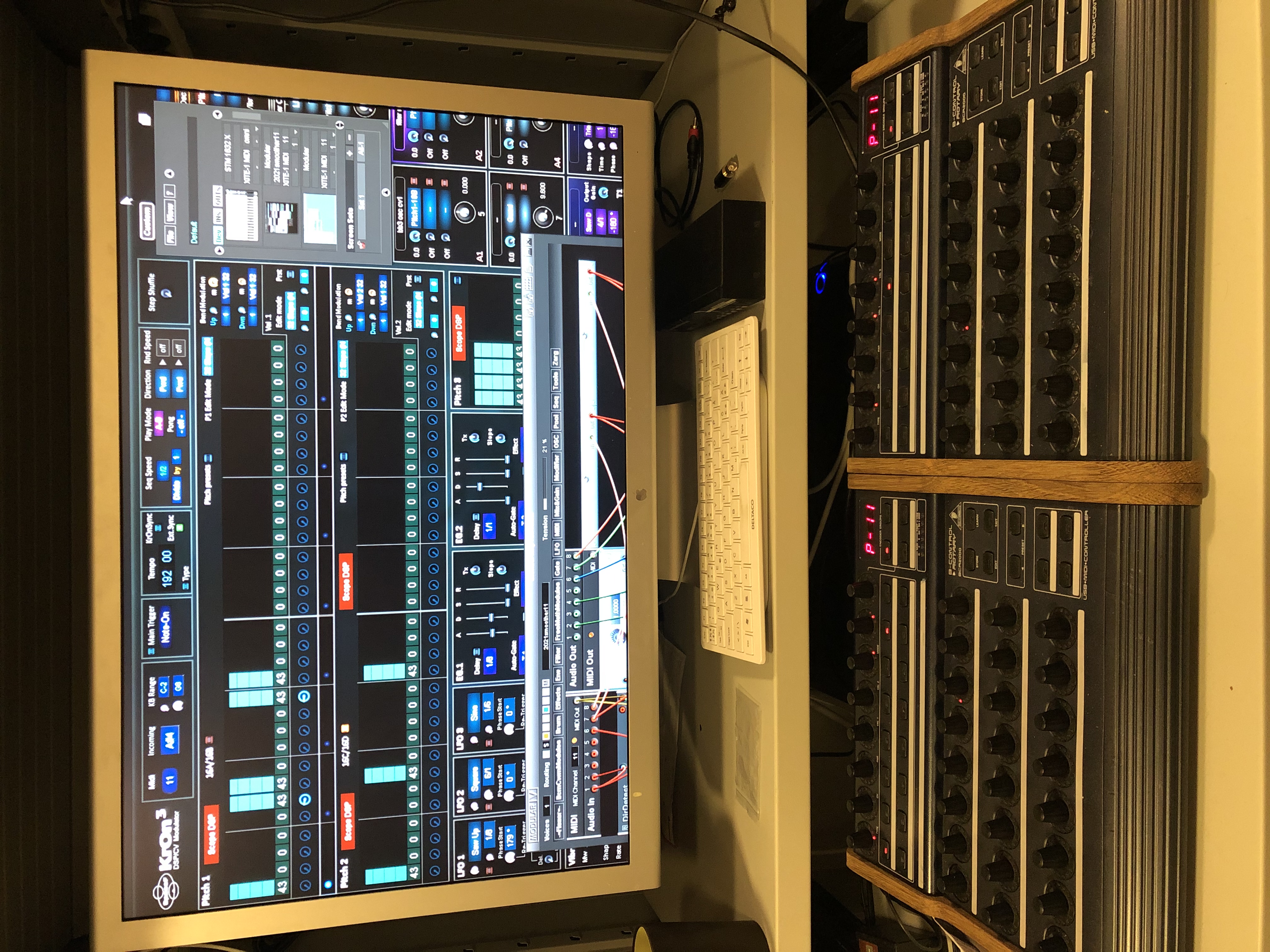

Xite Knight v2.0
Posts: 106
Joined: Thu Nov 19, 2015 9:10 am
Location: The Kingdom of Denmark, including The Faroe Islands and Greenland
Re: I would like to buy a Xite from SC
Post by Xite Knight v2.0 »
bassundgitarre wrote: Wed Feb 10, 2021 7:32 pm I wasn't ready to do anything for a few weeks. Corona simply stops the musician's work. You encouraged me to take this step. Thank you everyone for that. Now I finally bought my Xite-1 from Holger and I've had it since yesterday. I also wanted to give something back to Soniccore, although I can't afford it. The Xite was worth it. I am very excited about the performance. Sure, some things don't work that way. But therefor others :). And with strength. I had 23 Dsps before but what can I do with it now, wow. And of course there is also the DAW. I use Bandlabs Cakewalk Sonar. I'm really excited now to check out this forum and see how the crazy :) Scoper communicate with each other. I bought two BCR 2000s to do a little more with the remote control. Well, at least the Scope community has not shrunk for this day :) I look forward to a lively exchange here.
Congrats...and for those 2 BCRs, you could do like me and buy some nice oak panels from a guy in Germany :)

Hi Xite Knight v2.0
Na das sieht ja richtig gut aus:). Bist du gelernter Holzwurm?
What do you regulate everything with the BCR? I haven't had it all that long and have to get used to it a little bit ...

I’m not that guy. This is where I bought the panels: https://www.ebay.de/itm/Behringer-B-Con ... %7Ciid%3A1
I use the BCRs to control KrOn3 Max
Xite Knight v2.0 wrote: Thu Feb 11, 2021 12:39 am
Dual BCRs is awesome.
You have to be using Project Preset Lists/SR Pro with that.
If not you should look into it.
Everyone should be using those devices.
Great rig you got there.
