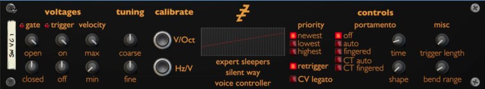

SilentWay Suite + Modular means audio becomes modulation source when using Modular.
I used it a long time ago and it really made Portamento more authentic.
Seems a higher resolution than 0-127 is required.
MIDI Spec 2 CC#88 allows 0-16,000 for PBend, you just need the same resolution I think with Andrews Pedal Steel.

Re: Active Sensing filter in Scope ?
I’ll ask Tiago who turned me onto this to resend me his instructions.
My Scope synths portamento was weak, also steppy.
Expert Sleepers SilentWay Suite changed that immediately.
I’ll catch him hopefully on FakeBook.

Yeah I read about Silentway when you first got into it years ago. If I was playing live I’d go audio rate modulation - silent way have a Reason RE as well, but you have to convert to audio first. It then routed to VST via the Reason CV connectivity.
For just tracking I probably won’t bother.
But yeah SW fits well into the Reason CV Ecosystem

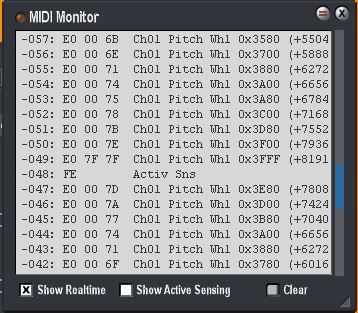

I think you can still troubleshoot this further. Use Midi-OX or another tool to watch the messages. Are you getting both MSB & LSB chunks? When doing a PB alone are you seeing smooth values or is there some discontinuity in the event stream (pauses, skips etc)?
Posts: 5055
This is what Im getting from the Scope MIDI Monitor (dont have MIDI OX installed). When held bend wheel fully open, there was time for one Active Sensing message before bringing the wheel back to rest position. Looks like 2 in every 3 values is skipped - maybe thats the issue. But when sequencer plays it back - maybe its filling in the missing values.
