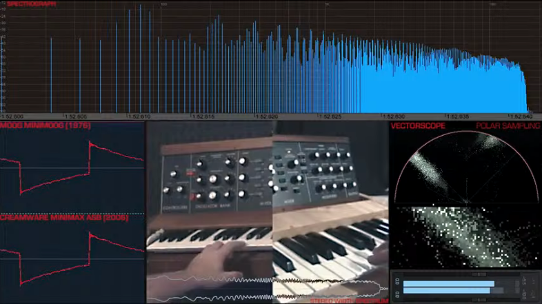

Post by Spielraum »
revealing A<>B comparison
thx for this cool and wounderful presentation!
Minimoog vs Minimax (vectorscope, spectrograph & waveforms).PNG (532.42 KiB) Viewed 42792 times
Minimax is a great Minimoog D emulation.
I owned 3 original (and modded) Minimoog D and still own one which actually is in service.
But also w/ the hardware,- it sounds different when playing the Mini via MIDI or via it´s Pratt-Read keyboard.
It´s similar to a Hammond tonewheel organ´s key contacts which are part of the sound.
The Minimog D´s keycontact springs don´t only close/open.
They smear over the busbars and it´s different for every single key since the alignment isn´t 100% perfect.
besides audio artefacts, one of the results is slightly different trigger point of VCF- and VCA- ENV per key.
None of the software emulations mimiks this.
The other difference is when using the audio loopback (audio-out back into pre-filter ext. input).
In fact, this behaves different in every single vintage MInimoog D already,- and what Minimax does in this department is sonically worlds apart from what my Minimoogs did.
Then, Minimax has a graphic bug in regards of it´s octave/footage switch.
Typing from my head I think it was in OSC #1 ... maybe #2 (?) ...
It annoys me all the time because it looks different than it sounds.
And,- when dialing in some of the "jan-hammerish" single OSC, clicky-percussive nasal flanged sounds,- the output level becomes very low and there´s no compensation for in Minimax.
It´s because when you want that clicky sound, normally produced by the keyboard contacts in conjunction w/ VCA ENV Atack/Release and Sustain settings, you´d have to set VCA sustain level below 6 or even lower and then don´t have any gain boost option when master volume is already 100%.
I dunno how it is w/ ASB/Klangbox which you run into an amp which itself is a gain boost option then,.- but in SCOPE it is like described above.
In SCOPE it helped running into an amp sim though,- but then it´s often crap to have Minimax´ FX before amp, especialy the DLY,- but sometimes also Cho or FL.

That also rules for many other instruments.
You´ll get the sound from emulations,- more or less close and sometimes very close,- but you´ll always play different on the MIDI controller keyboard vs. the real instrument.
You adapt to imperfections of the real and continuously ageing instrument,- the old keyboard mechanism, pitchwheel w/ signficantly different behaviour and inaccurate range, connect CV pedals w/ wide travel and audio taper pots (instead of linear ones typically used in expression pedals)) and so on.
You play and grab a pot to re-ajust sound while playing,- do that w/ a mouse.
And when you programmed a MIDI controller to make changes,- it doesn´t look like the front panel of the Mini or any other real synth.
And yes, I really hate preparing MIDI controllers to do so,- it´s wasted time for me.
So, when playing Minimax, I use the preset memory, select a patch and play.
With the real deal, I turn knobs, use pedals and bring it to life that way BECAUSE it doesn´t offer preset memory.
But the advantage of Minimax is not only the very low latency when running SCOPE standalone,- in addition you can make it polyphonic, it has FX built in,- and I already mentioned above,- it has presets like the Minimoog Voyager p.ex..
I don´t think the Minimoog Voyager sounds better than Minimax does.
