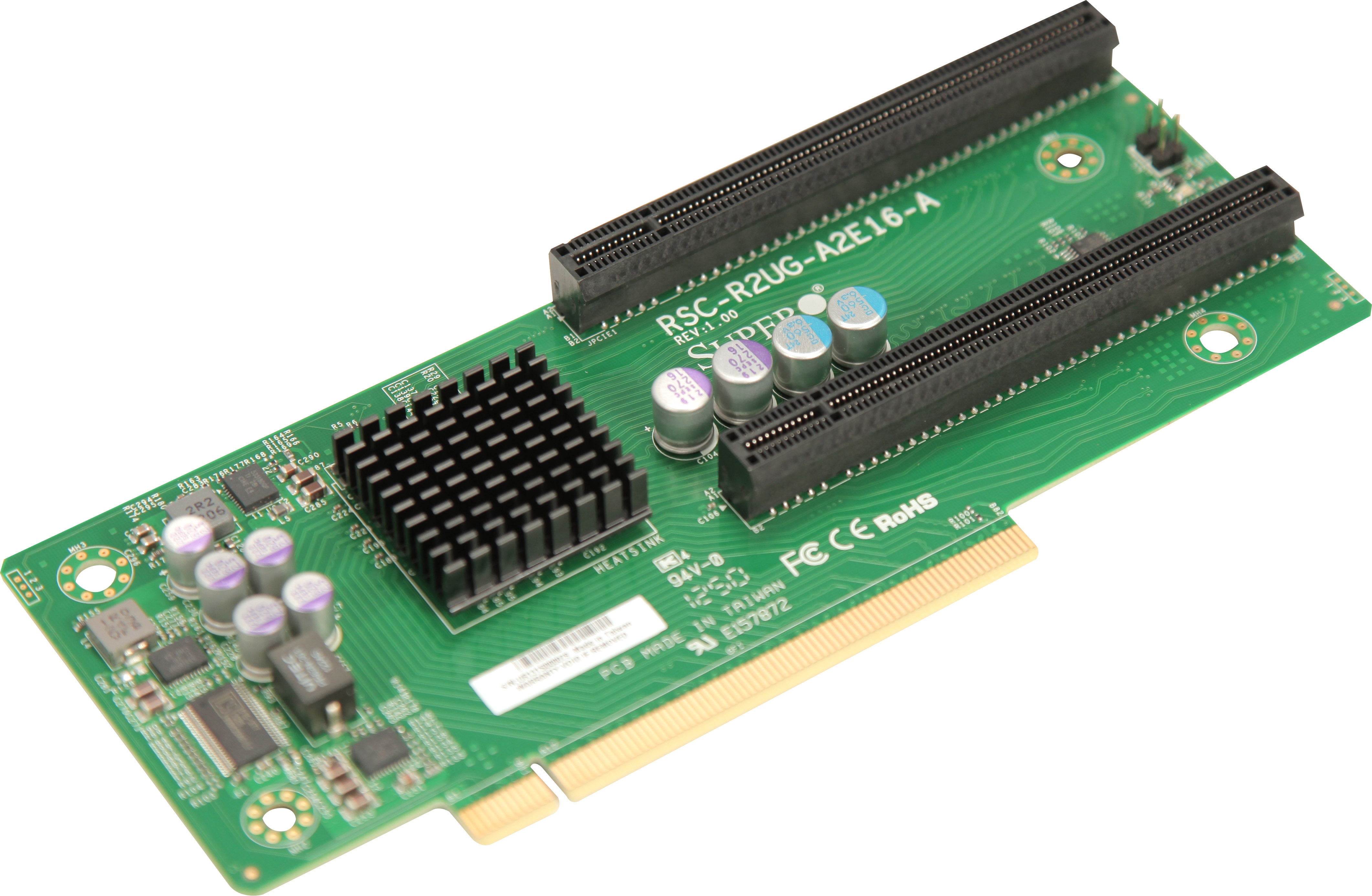

I found what I needed @ Supermicro.

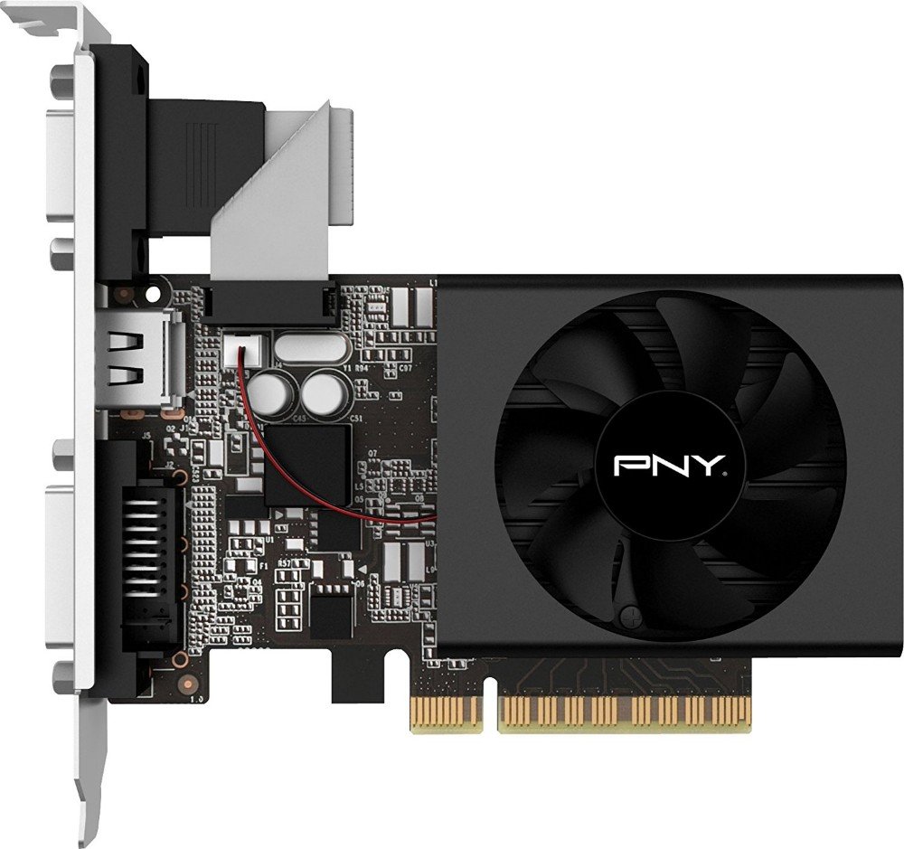

I need a cheap 8x GPU for 2D.
And a 1X for XITE-1 PCI-e.
I’m told the 16X on a Mini ITX has enough juice for an 8 + 1.

I like Supermicro :) Wasn't sure you were willing to pay ~$300 though. Also I believe that's a 2U...so you might need a 1 slot GPU...

Actually a 2U for the Nanoxia 2U.

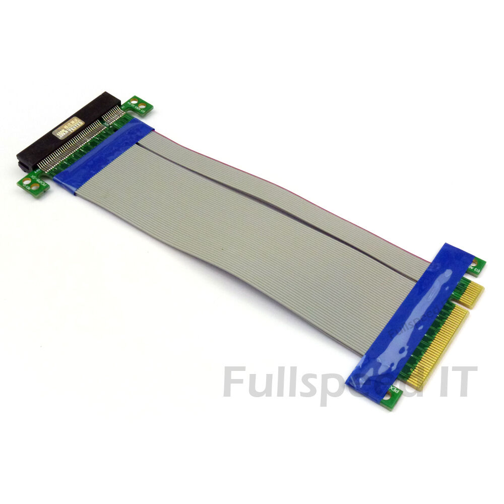

Here’s the GFX 8X Card and connector ribbon.
Just put XITE-1 PCI-e 1X on 2nd slot.

Yea it was the clearance for the GPU i was concerned about, wasn't sure what size case you're using. The ribbon should solve that for sure. :)

Splitting up power on a riser card where a 16x renders an 8x and a 4X
PCI-e Bifurcation is what they call this.
Has to be mentioned in the manual that the BUOS will allow this.

And that's where the bridge chip comes in on that riser card. Thanks for keeping us updated Jimmy :)
