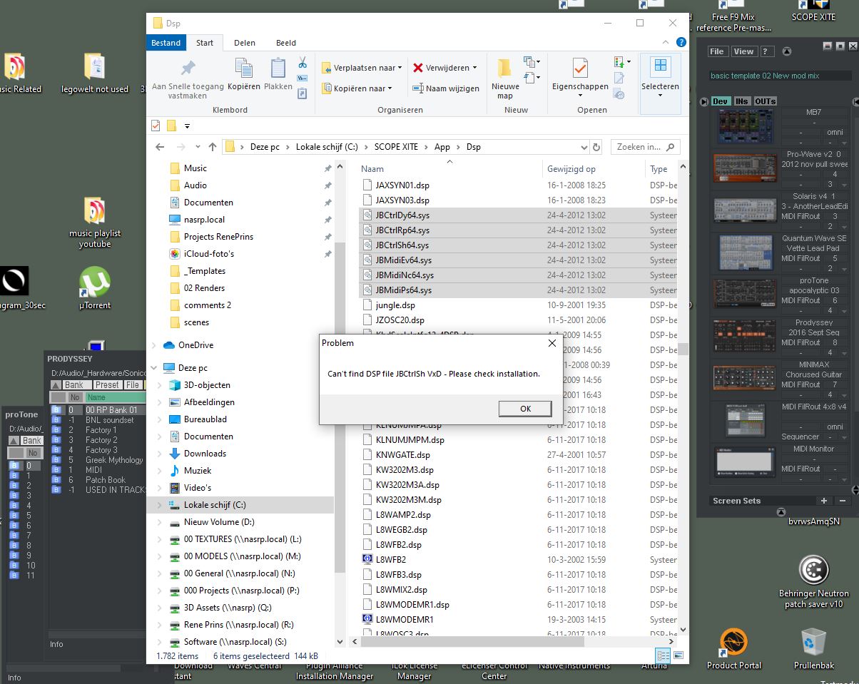

I've had the same problem when I upgraded from Win7 to Win10. I had the same BSOD's, especially with Q-Wave. There were some "solutions" in the troubleshooting threads, but they didnt work for me. Not exactly sure what I did, and why, but I remember putting the 64-files (JBMidiEv64.sys, JBCtrlRp64.sys, JBCtrlSh64.sys, JBMidiNc64.sys, JBMidiPs64.sys) in de DSP folder instead of the SYS folder. When I then opened Qwave or Solaris, I still got the error "Can find JBCNTRLsH VXD" for each file, but those can be ignored, as the VXD is something for WinXP I've read here somewhere. Since this "trick" I can load Solaris and Qwave without BSOD's (only the vxd warnings that can be ignored)
Solaris + Qwave files.JPG (200.86 KiB) Viewed 7330 times

RP_001 wrote: Fri Nov 15, 2019 4:53 pm I've had the same problem when I upgraded from Win7 to Win10. I had the same BSOD's, especially with Q-Wave. I remember putting the 64-files (JBMidiEv64.sys, JBCtrlRp64.sys, JBCtrlSh64.sys, JBMidiNc64.sys, JBMidiPs64.sys) in de DSP folder instead of the SYS folder.
I tried this, it did not do the trick for me!

RP_001 wrote: Fri Nov 15, 2019 4:53 pm When I then opened Qwave or Solaris, I still got the error "Can find JBCNTRLsH VXD" for each file, but those can be ignored, as the VXD is something for WinXP I've read here somewhere.
If my memory serves me right, the VXD-files are a font-type for the plugins.
From the QWave manual:
"There are some custom files that need to be installed. These are in a folder called, ‘Quantum Wave App files’. Simply drag the Vxd and Sys folders inside into your Scope/App/ (SFP/App/) folder"
Do this, and you wont get the error-messages anymore :)
