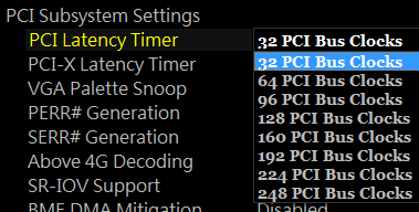

Hello
My Scope 7 setup is 3 PCI cards on Asus tuf h310 plus gaming, everything is ok at 44.100 and 256 buffer size and rocking 12 masterverb in an empty project.
I was searching in bios the "PCI Latency Timer" setting and there is no user option to set it up, so reached Asus support and the say I quote.
"Thank you for your patience.
After we looked into the matter, we can only change the value of the PCI Latency Timer at the background, but we cannot release this setting to you.
Please reply which PCI Latency Timer setting did you want to change, the “PCI Latency Timer setting” or “PCI-X Latency Timer setting”.
And please reply which value do you need.
All the items have been listed as below."
It seems that they can change it for me and the default value of the timer is 32-bit clocks,
DEFAULT
I ask them to change it for me to 64-bit clock.
Modifiable Value of PCI Latency Timer
My question is can I benefit from this change?
Or should I ask Asus a different value?
Best,

iirc PCI latency timer defines the maximum amount of clock cycles that a card can claim the bus for itself and lock out other cards. Default values are usually ok and it's not even relevant if you fill all your PCI slots with Scope cards.
(in contrary to running a PCI Raid controller on the same bus, for example)
Re: PCI Latency Timer setting?
probably not worth worrying about.
in the early days, it really mattered....

@plonter wrote: Mon Jul 01, 2019 11:29 pm [...]
Doesn't hurt to try. If I remember correctly, back in the day some other card on the bus (my matrox g450?) would override this setting. Nowadays with EFI/UEFI, the OS seems to have taken over BIOS settings anyway.
But hey, it's free to try, doesn't break hardware and may change some things for better or worse. I'm sure you'll let us know :p

Finally i received the modified BIOS from Asus, i see no different, still 11 Master Vereb and Pci Limit.
I'm attaching the modified BIOS maybe it can help.
I'm wondering if it is to make a change what would it be.....
