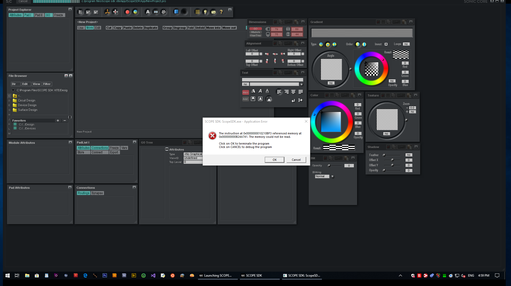

Hi There,
Suddenly SDK decided it would not load (crashing during load).
It appears to be a memory violation - see the attached screenshot.
Scope 7 runs without issues.
No new apps have been installed or updated afaik between the time it was working and when it started to crash.
I guess windows (win 10 64bit) may have updated, not sure about that.
I reinstalled but no change.
I cleaned and reseated the RAM chips
I checked the IRQ, but of course scope and scope sdk share drivers and scope works fine
IRQ 19 is assigned and it is shared with some USB controllers and Serial Ports, but they report no conflicts.
You can just see on the screenshot that it crashes before reaching full loading.
Anyone have any thoughts on what I might try?
Regards
maus
Scope SDK Violation.png (311.23 KiB) Viewed 3328 times
Re: Scope 7 SDK suddenly crashing
If it’s something that use to work and stopped, I’d try removing any anti virus protection.
I had very similar issues but with a certain plug in.

For the record, I figured out that it was something in my device design that was causing the crashes.
Can't load it to find out what and I now have to go back to an earlier iteration and rebuild.
Anyway I found when you redesign something it often improves it.
SDK all is forgiven.
maus
Did you try to remove the last windows update ?
