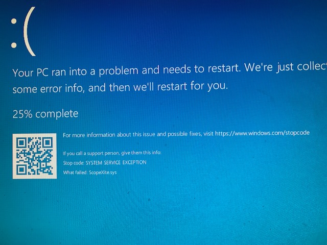

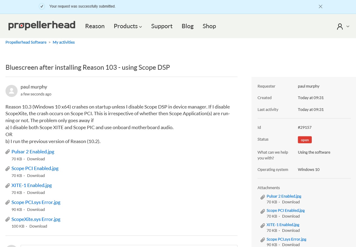

After installing Reason 10.3 it crashes accessing Scope on startup. Interested to see if mine is an isolated case (any other Reason users here ?)
Here is the ticket I raised with Propellerheads :
Propellerhead Ticket
Propellerhead Ticket 29157.jpg (138.69 KiB) Viewed 5674 times
ScopeXite crash
ScopeXite crash
ScopeXite.sys Error.jpg (118.09 KiB) Viewed 5673 times

I would guess Propheads have modified the initialisation of audio ports as part of their audio engine rework (which has taken a few months). So if you disable Scope in device manager prior to starting Reason then select the MOBO driver, then close Reason - re-enable Scope in device manager, then restart Reason it will start OK because it remembered the last active (non Scope) audio driver. So then, if you go to Reason then try to select Scope as its audio port, then crash occurs. So then - after reboot from crash - you have to disable Scope in device manager - restart Reason and select Mobo sound. From there its OK again (but no Scope).

Here's reply from the props :
"Thanks for reporting! If you install a logging version of Reason 10 on your computer, R&D can use the logs to pinpoint what goes wrong. You can download a logging version of 10 here:
http://cdn.propellerheads.se/logging/re ... dbanks.zip
This version will install to a different folder than your current Reason installation, and will leave your standard version unaffected. Please run this, re-create the problem/crash and send us the log files generated by Reason. You'll find the logs in Documents\Propellerhead Logs
Please report back!"
So I've sent logs back to props and Holger - keen to know if anyone else wants to try logging ver and gets the same crash or not.

Just got the following from the Propheads - if anyone else wants to test. Ill test tomorrow & fwd to Holger
Hello
We are working on a fix to a similar problem as the one that you reported.
It would be of great help if you could try to reproduce it in this build:
https://www.dropbox.com/s/wiwwnz91yp4pd ... s.zip?dl=0
https://www.dropbox.com/s/h4ssrg89s3y4i ... s.dmg?dl=0
This is a slow logging build just meant for testing this problem, so please switch back to normal Reason version when you’ve tested this.
