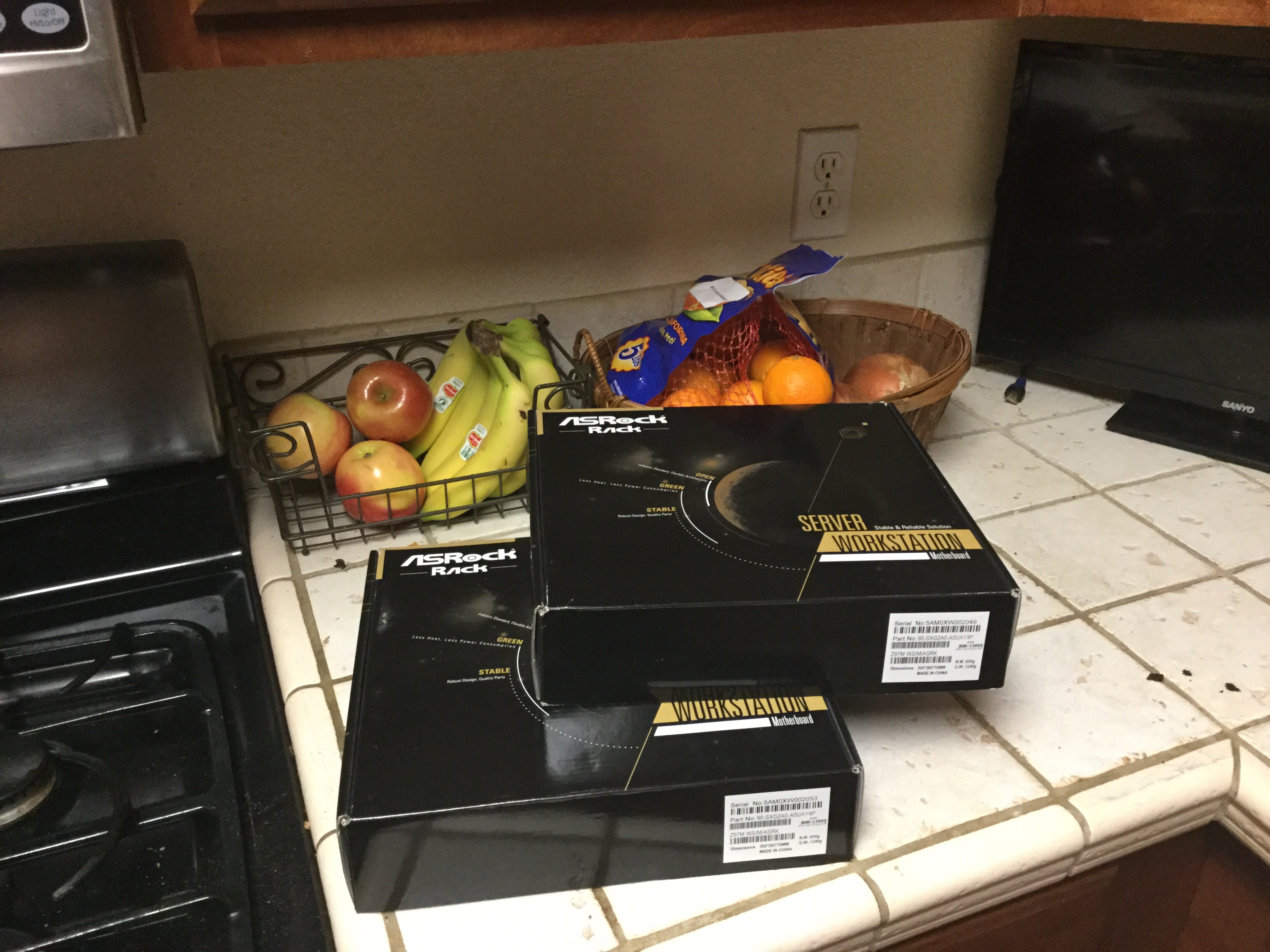

Hey I like the 4790s so much and they’re dirt cheap right now, I just bought 2 x more @ Newegg for 700 bucks and two rare 1U Z97m WS ASRocks for 250.

Re: How do I overclock my i7-4790 ?
FWIW I have 2 x brand new ASRock Z97s I’m never going to need.
For giving us Scope Rise they’re yours for the price of shipping,
One board has been put in a 4U as a spare and has maybe 49 hours on it.
The other has never been opened, still has sticker and plastic.
Give me the word and they’re yours.
I’m way overstocked with C236 boards too.
I went nuts with builds and must have parts for 10 PCs laying around.
