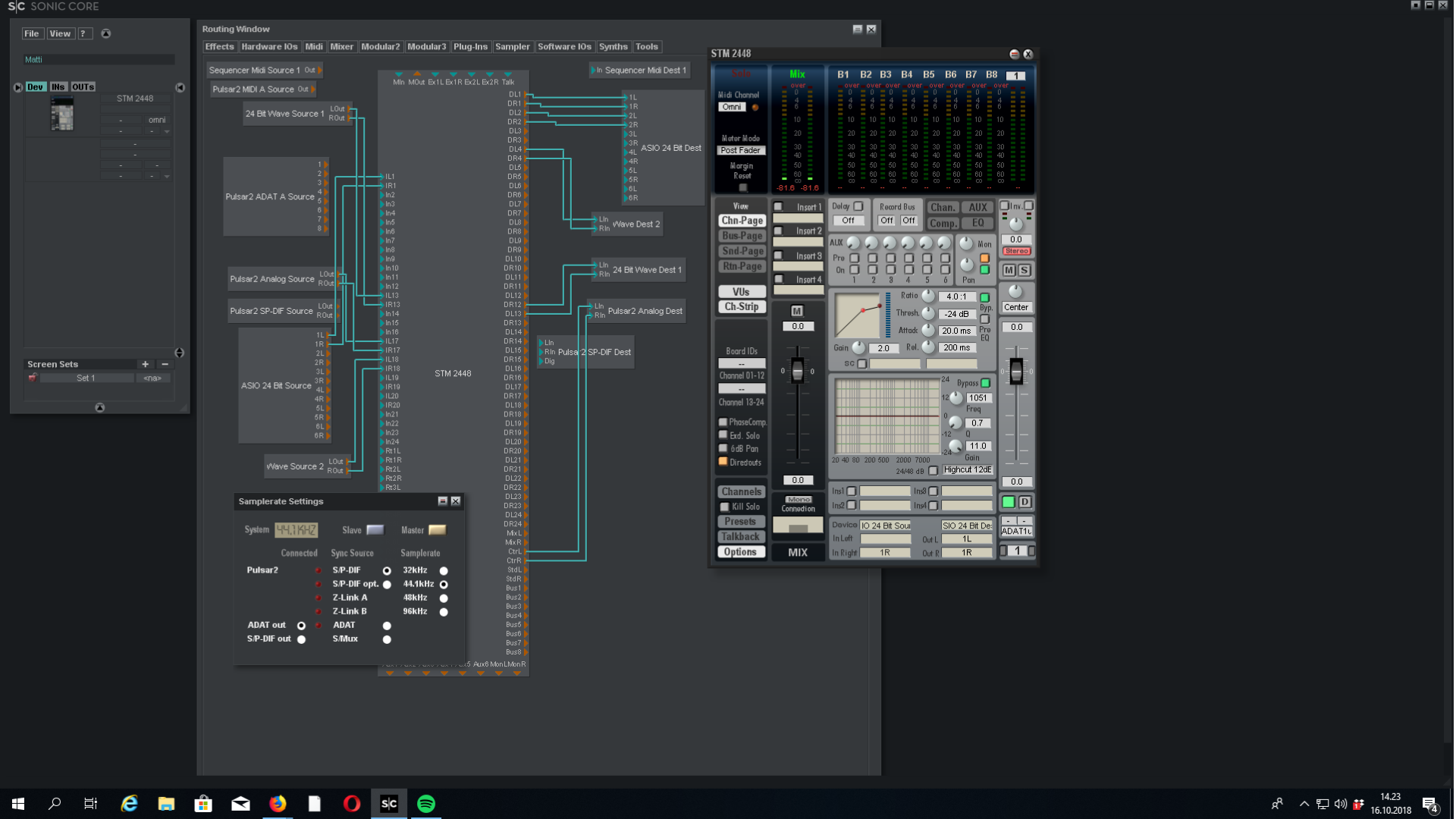

SCOPE Platform-Matti.png (422.19 KiB) Viewed 6368 times
Re: Voice problem
Posted: Tue Oct 16, 2018 3:32 am
by Matti
Here above is my SCOPE Platform if this help?
-Matti

Ps: DL outputs are Direct outputs from the inputs with the same numbers, so, DL 4 will not output any sound and DL12/13 will only output the signal from one side of In13. But that is another issue not related with the OP.

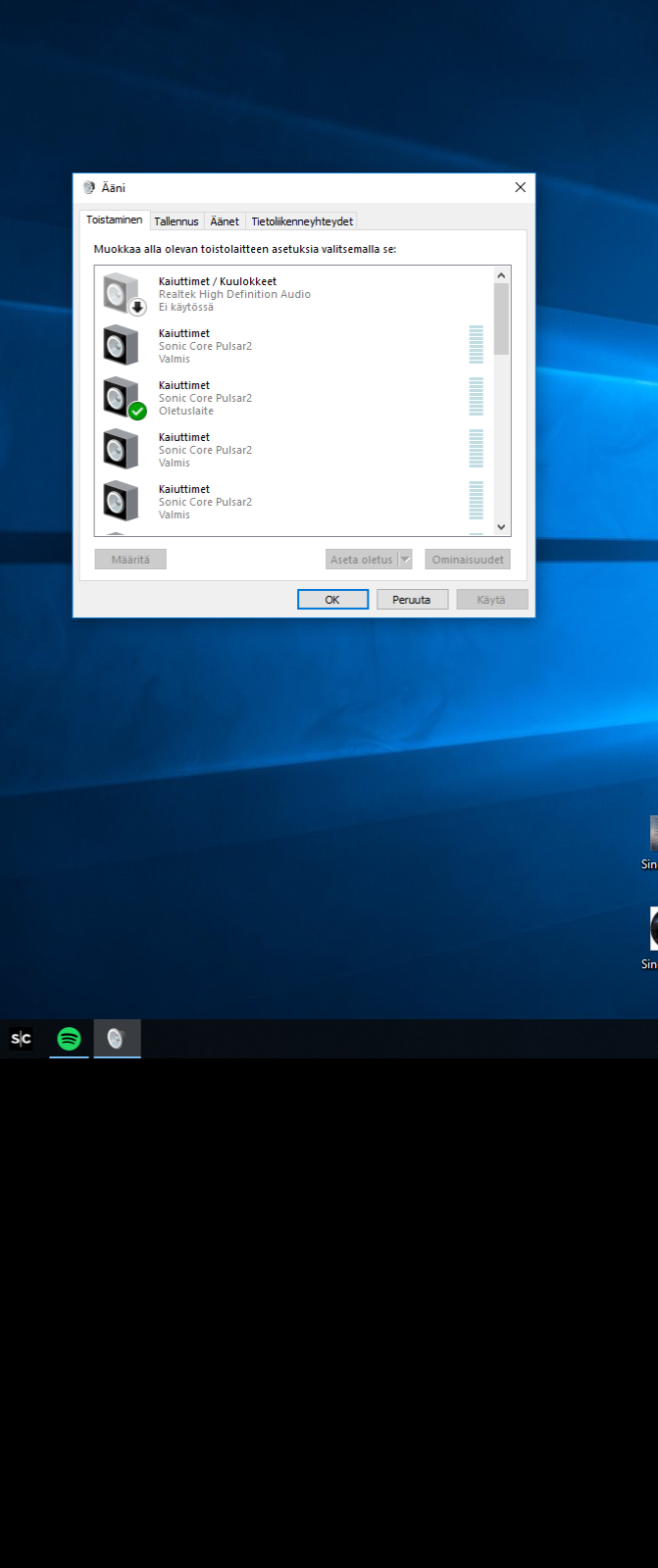

by garyb
did you click on the speaker icon near the clock and choose the SonicCore speakers in playback devices?
windows 10 works for sure.

by Matti
Yes, have have. -Matti
