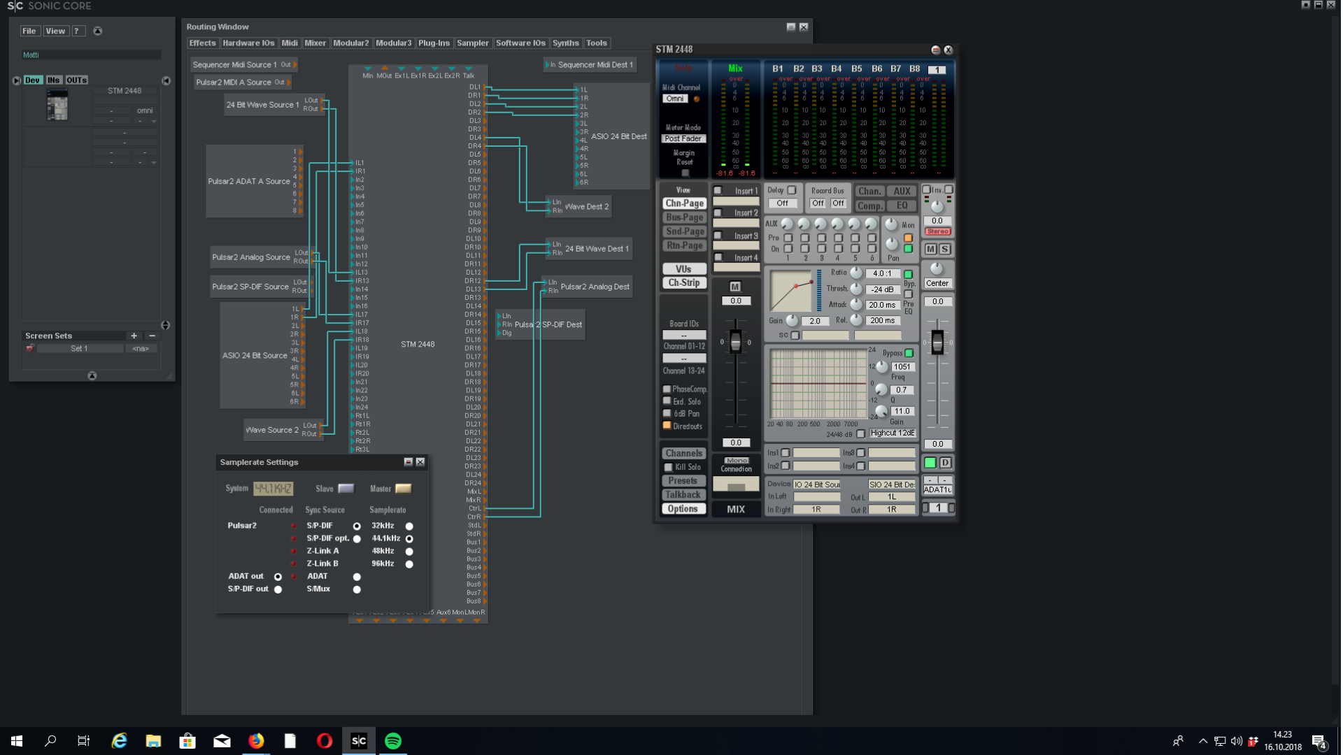

SCOPE Platform-Matti.png (422.19 KiB) Viewed 6376 times

Post by Matti »
Here above is my SCOPE Platform if this help?
-Matti

Ps: DL outputs are Direct outputs from the inputs with the same numbers, so, DL 4 will not output any sound and DL12/13 will only output the signal from one side of In13. But that is another issue not related with the OP.

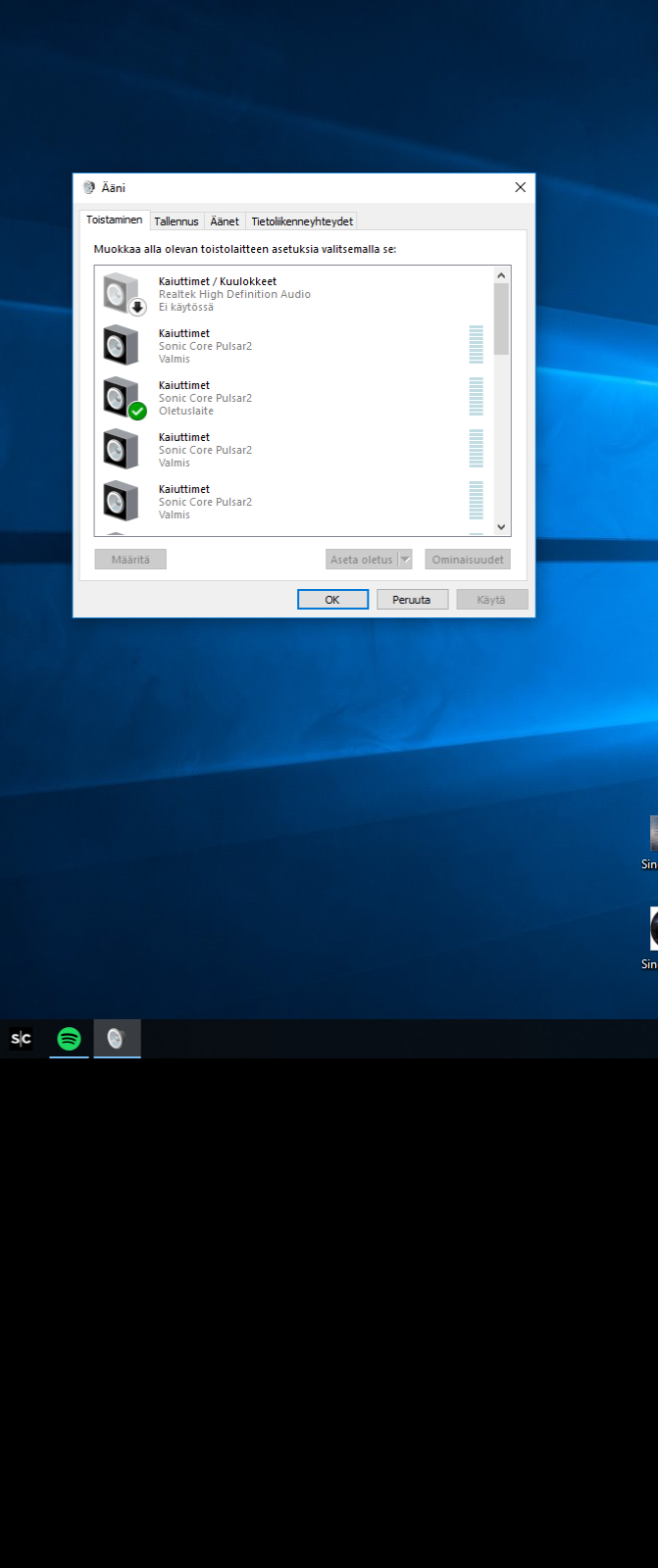

Posts: 23414
Re: Voice problem
did you click on the speaker icon near the clock and choose the SonicCore speakers in playback devices?
windows 10 works for sure.

Post by Matti »
Yes, have have. -Matti
