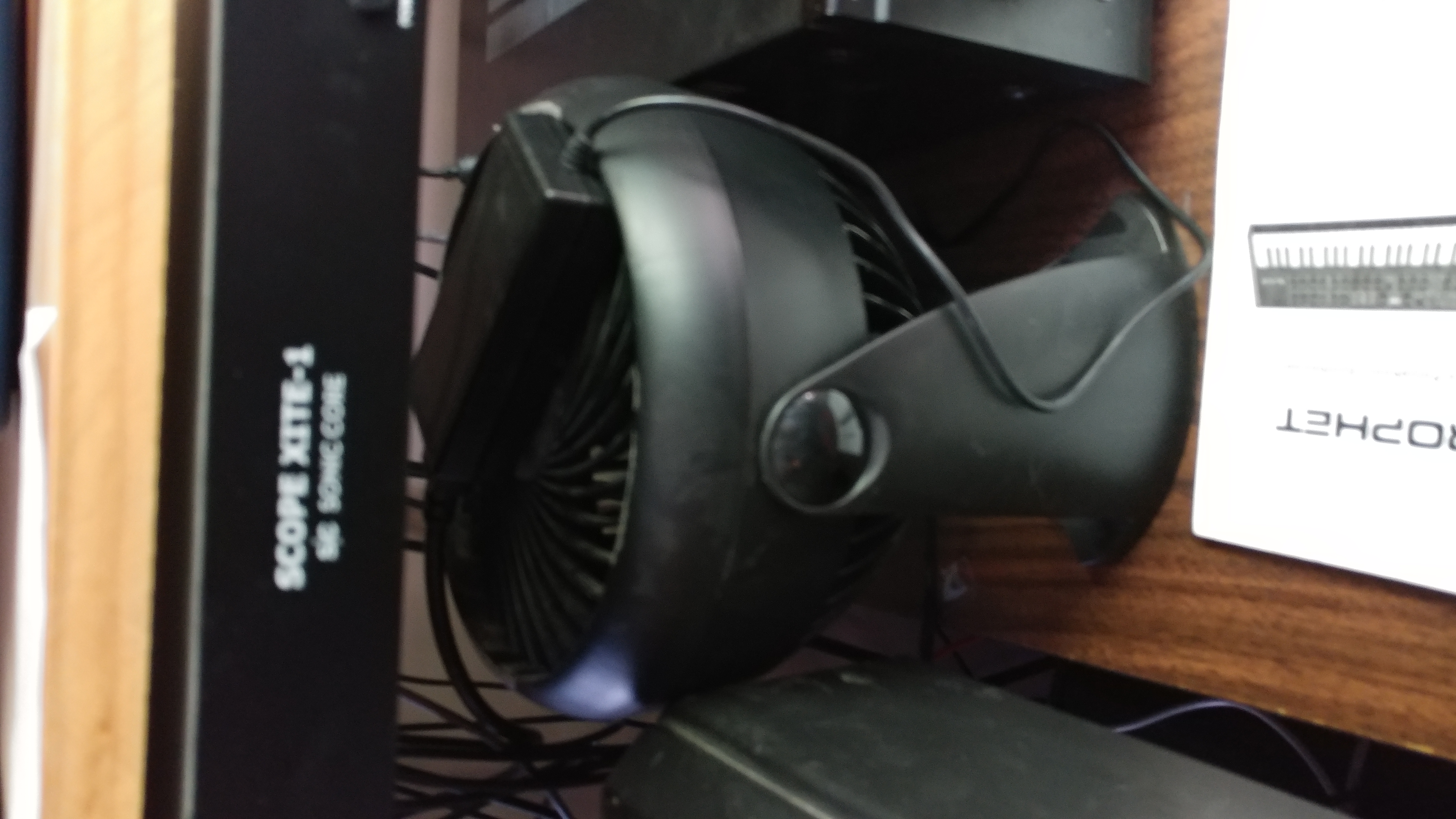

Fan under the Xite with the pwr supply right on top of the fan. Not needed? - maybe, but long term maybe buy me a few years. I also have a big fan in the window sucking out the heat which cools the entire room dramatically.

				- Xite fan.jpg (3.4 MiB) Viewed 9724 times
