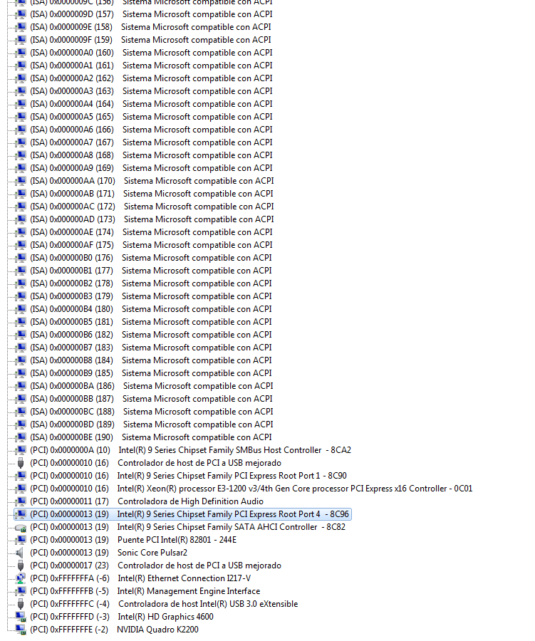

Re: Configuration problems in Win 7 SC 7
How does it look?
- IRQs.png (128.45 KiB) Viewed 7084 times
that should be ok.
system information is easier to read...(how to get there is in the link).
most importantly, is EIST and Hyperthreading turned off?
