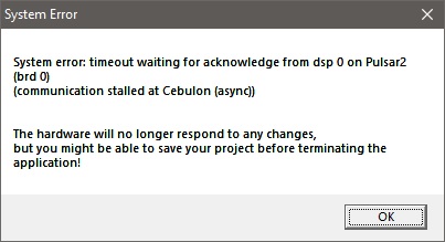

Periodically, my soundcard stops working with the error message:
Code: Select all
System error
timeout waiting for acknowledge from dsp 0 on Pulser2 (brd 0)
(communication stalled at Cebulon (async))
The hardware will no longer respond to any changes, but you might be able to save your project before terminating the application!
[OK]
Do you have any idea what might be causing this and how to stop it?

Despite being a competent solderer I was nervous of taking the caps off my precious Pulsars!
So I've been getting by the last four months by keeping the side off my PC and giving the soundcard a nudge in the PCI slot every time it failed. It was very annoying though because every time the dialog popped up I'd have to restart the Scope software. It was popping up once or twice per evening.
On about three or four occasions I took both Pulsar IIs out of my PC, removed the ADAT daughterboard from one, and used electronic cleaning solvent on all the internal connections. It never really helped for more than a few days.
Last week I had the idea to move the ADAT daughterboard from one card to the other so tried that and am happy to report that I haven't had the issue since then - it seems to be fixed without needing to replace the caps. :D

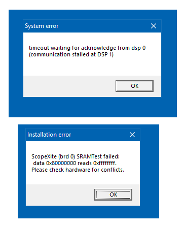

Got this error on XITE-1.

I‘ve had this error numerous times on a Pulsar, and it had nothing to do with the SRam.
If the error persists, check the cap located between wordclock and midi, it may have come off.
(it might be faulty, but that‘s not very likely, considering it‘s relatively short time of usage)
Of course that‘s just a hint for a quick check. If you feel uncomfortable with opening the unit, contact support.
In my case replacing the caps (4 in a row on a Pulsar) solved the problem.
(the io system with the 2 SRams seems identical for many Sharc designs)
