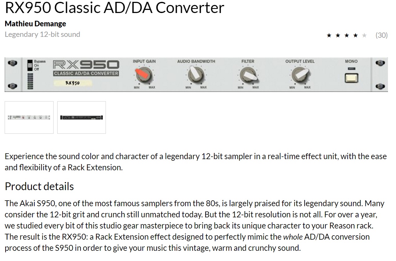

Re: Merits of going 24bit/96khz?
garyb wrote: Sat May 05, 2018 12:43 pm that is generally a good approach, however when it comes to sample players, i'll just remind you that some of the greatest sampled sounds have been 12bit and under.
So much so that is a desired sound. Just got this recently so can apply it to modern samples :)
RX950
RX950
