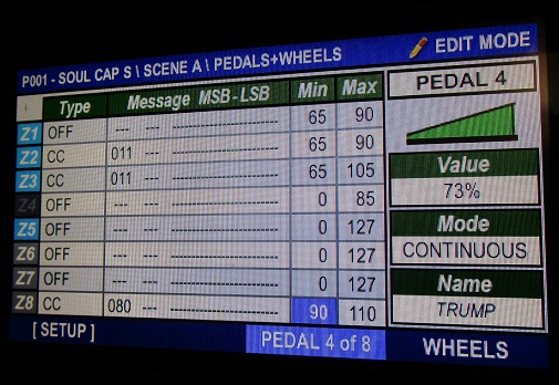

Below is the Physis K4 Expression Pedal Controller view.
Top 2 slots and Bari and Tenor Saxes.
Then Trombones Trumpets, all controlled using CC# 11 in Kontakts Mixer.
Bottom slot is Scope Mixer Channel.
