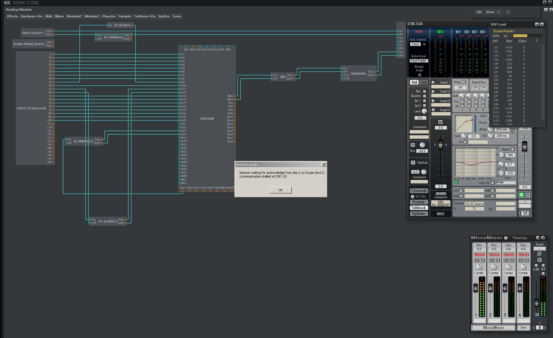

Is there a better board than the one I currently have (Intel DH55HC, BIOS TCIBX10H.86A.0037.2010.0614.1712 06/14/2010)? WinXP 32bit dedicated non internet connected system with most non-necessary services disabled. Its an old 1156 board, but I am getting PCI limit reached errors with only half of 21 DSP used with V7. Maybe there's some tweaks I've forgotten? Loaded RMX160, SC ambience and SC plate reverbs (3 in total). Just mucking around with v7 and planning on getting back into it. I would be interested in building a stable system.
- TimeoutError.jpg (194.01 KiB) Viewed 76877 times
Stuart.
