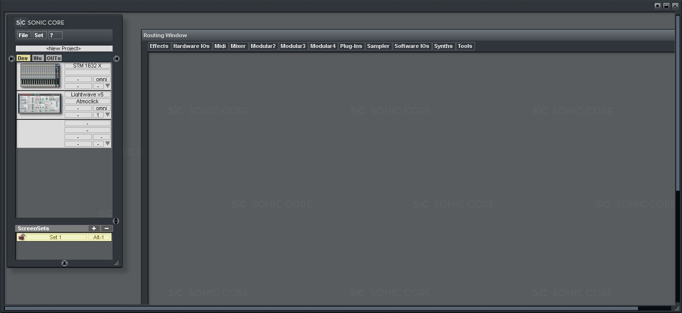

The searchpath points to the Xite-dir.
If I create a project on Xite ( clicking some devices into routing window), I can see them in den DEV-bay aswell.
Now I load an old project.
The DEV-bay still shows the Devices, unchanged.
But the routing window becomes empty.
see screenshot

Re: cannot load pci projects on Xite
is there a pci install on that computer?
if so, rename the Scope PCI folder, temporarily.
load the project, it should ask for locations for all the devices, browse to the locations in the Scope Xite folders.
save the project as a Scope XITE project.
i believe the problem is that the projects carry addresses for files, in this case, for files from the PCI system. when you open the project in XITE, the files get loaded from the PCI folder, which doesn't work. by renaming the Scope PCI folder, the Scope XITE application has to ask where to find the files that are no longer present. pointing to the XITE files should load the devices properly. saving as an XITE project locks the file address to the XITE files.
Oh yes ! Very good idea !garyb wrote: Sun Dec 17, 2017 1:51 am is there a pci install on that computer?
ThanX a lot !
With my removed ScopePCI-folder I can load my old projects. ( 5.1 xite and 7 Xite)
