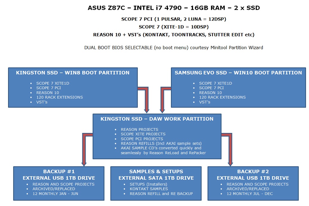

I've got the Win8.0 Z87C - i7-4790 rig described here http://www.hitfoundry.com/issue_25/daw_mast.htm
My plan is to get a 250GB external SSD (USB3) and use WinToUSB to make it bootable and install Win10 on it, Scope 7, Reason 10 etc and get a workable dual boot scenario. eg select which one to boot from BIOS.
Once everything confidently up and running on the SSD I could then blow away windows 8 on the internal SSD and setup Win10 there.
Would this be a viable plan ?

Im running Win10 on my other laptop for ages, so faimiliar with it. Ive got another plan - inside the case theres a second SSD mounted on mobo, so Ill just move stuff from there to USB storage and make that bootable. Hopefully easy.

It worked. Got a dual boot system Win8 and Win10. All running with Scope 7 PCI and XITE-1D. Application wise the main difference is no Cubase on the Win10 install. I’ll leave it in the Win8 install in case I need to extract any legacy projects.
Good to have up to date system, Win10, Reason 10, Scope 7 - and no Cubase :)
This Scope 7 update was a great motivator to set up under Win10 - so thanks to Holger and GaryB for making it all happen and propel the Scope platform for the next decade.

In an attempt to fresh install with Win 8 partition (it had a small MIDI error) I accidentally blew away the boot block for the Win10 partition. Partition Wizard MiniTool Free to the rescue - now I got the dual boot nailed - bios selectable.
