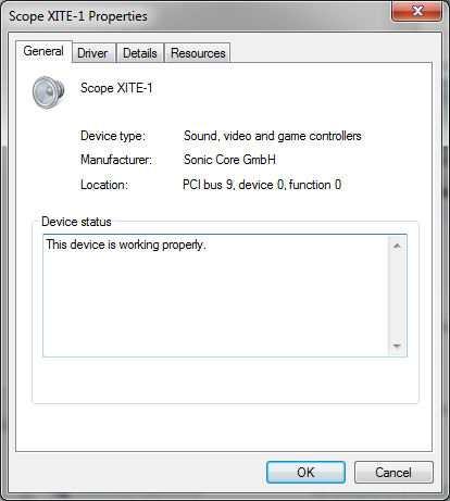

garyb wrote:device manager\sound, video and game controllers\XITE-1\properties\settings tab\ in the middle of the page "midi devices". enter the number of midi devices that you want Windows to know about.
Nothing like that here:
Posts: 1711
Re: Xite MIDI 1 and MIDI 2 ports
my system's the same. PCI cards do have that option.
I'm on Win7 64bit

garyb wrote:what about the details page?
i've moved 1200 miles so a lot of stuff is still packed and i can't check for the setting.
if it's not there, then you would need to remove it manually from the registry, as you suspect...
Nothing related to MIDI or AUDIO devices. Like Ids, error codes, addresses etc.
