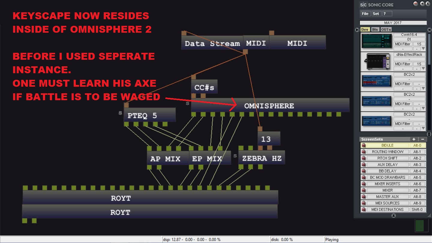

Re: Ryzen Chipsets
Still going to build a Ryzen for general anti Intel purposes.
But forget about 8 cores, 6 will do.
I never get much time off and usually go from group to group, 3 x different bands I work with, learning new material, making sounds.
2 weeks off and I learned how to use Keyscape Creative and run it inside of Omnisphere, like Trillian.
Now I got plenty of overhead even in Dual Live Mode running multiple layers instruments/
PianoTeq and Keyscape are fantastic together.
Omnisphere 2 and Zebra 2 HZ are also Dogs That Hunt....

Re: Ryzen Chipsets
Success is achieved.
Z97s with i7 4790k are more than enough.
You need more mature expensive VSTi instruments that reside on a specific core.
Kontakt CPU 0
PianoTeq Pro CPU 1
Zebra2 HZ CPU 2
Omnisphere/Keyscape/Trillian CPU 3
This is my rig until I tire from it, doubtful.
