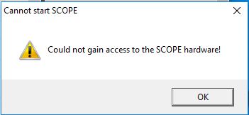

Having an issue regarding a new install on win 10.
I managed to run the installer with no issues after enabling test mode. The drivers show up fine, the Luna was recognized as "Scope PCI X" or something similar.
However, when i try to launch the Scope app as admin, i get the following error
pressing OK brings up the following:
If i try to run it again afterwards, it says:
I haven't been asked for serials/allkeys yet. I have tried to reinstall, no luck.

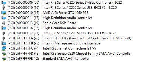

And no IRQ conflicts.
