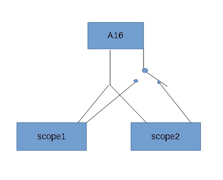

I use the A16 as Master and as Slave.
Normally the A16 powers up as master/48khz. Most of the time this works "crack-free" for 4 hours.
If cracks show up, it sometimes helps to switch the A16 to slave.
I also used an external clockgenerator to drive the wordclock of the A16. The A16 and scope ( now being slave at adat) perfectly follow the clockgenerator.
But even in this case, the data, which goes from scope to A16 gets crackly, as I can seen in my echos attached to the A16.
As I have two identical PC connected with an Adat Splitter/Mux to the A16, I can determine the signalpath that is faulty.
( see picture attached)
The Adat-Splitter is not causing the problems, as they remain when removing the splitter.
I somehow suspect the effect of heat, that slowly increases over time in the A16 and PC..but I wasn't able to measure any bad signal yet..

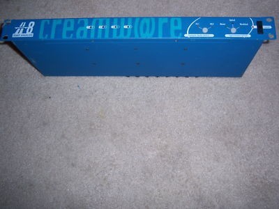

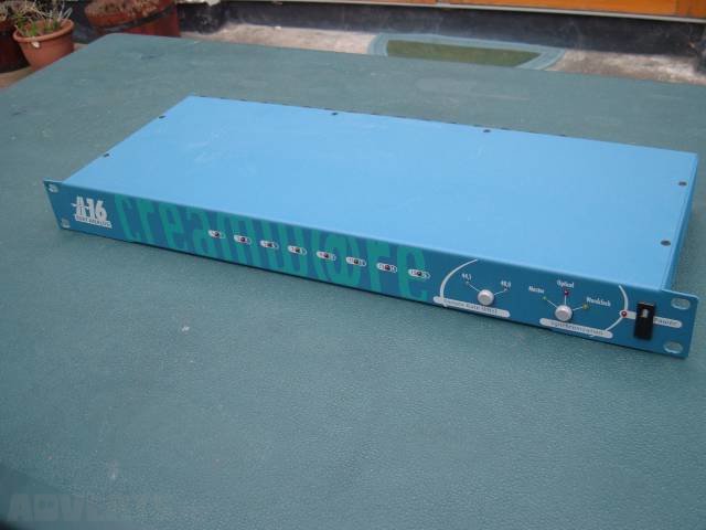

Are these the units you are talking about? (A8 and A16)
or do you have the A16 Ultra? or Blackface Sonic Core A16U or newer Ferrofish A16 Ultra MkII?
nebelfuerst
Posts: 609
Re: hacking the creamware A16 ?
Post by nebelfuerst »
yes. these blue items are right beside of me.
