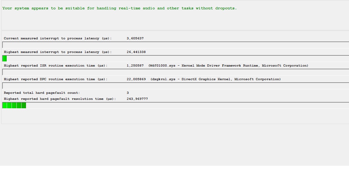

I have time to time problems while playing project or recording in Cubase 8 Artist with audio glitch.
Even if i have project loaded just from 20-30% or less.
It happens random.
I have checked few things, but can't figured out.
Latencymon shows low values and no problems there.

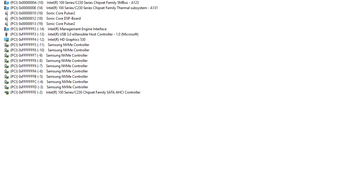

IRQ's are fine.
All i can think is :
-integrated graphic (intel i7)
-page file ? i have 16gb fast ram
-m.2 ssd on motherboard with windows 10 64bit installed
any suggestions maybe, what i can also try ?
