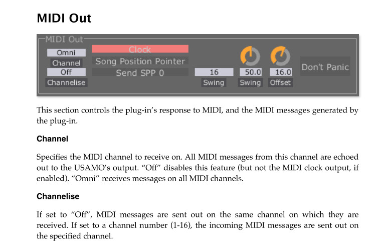

--> Shogunspy --> Are you sure usamo is only one midi channel ? I tried to find this information without any result. Where did you see that ? One channel should be enough but several is better ! I'd like really to know and be sure !
Re: Usamo box
In fact, by reading the usamo plugin manual, I can read :
usamo midi.jpg (67.35 KiB) Viewed 7931 times
So, it seems usamo can send incoming midi messages on the same channel number it is on the daw track or it can be sent out on a the specified channel.
Of course, I'll be absolutely sure only when I'll try it but apparently, you're wrong, Shogun... I hope you(re wrong.. :D

Shogun, the link you provided seems to confirm 16 channels ! See last post of "os" on that page : https://www.muffwiggler.com/forum/viewt ... &start=375

Ah, yes, I was forgetting ! The usamo uses 16 midi channel, no doubt ! :wink:
