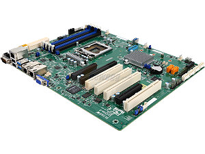

dawman wrote: IMHO Supermicro's C236 Xeon boards are awesome.
Was checking their site and that motherboard model.
http://www.supermicro.nl/products/mothe ... 1SSA-F.cfm
Looks very nice indeed and everything you need.

Re: Mobos and pci slots in the future
quite high? for recording studio equipment or gaming boards?
anyway, i really don't know how well the socket 1151 config works with Scope cards....
it might be great, or it might not be so great.
the thing about Supermicro boards in general, is that they are made for mission critical use, 24/7 servers. they are made to last a long time, so they are made with the best parts. customer support is also unbelievably good in my experience, too.

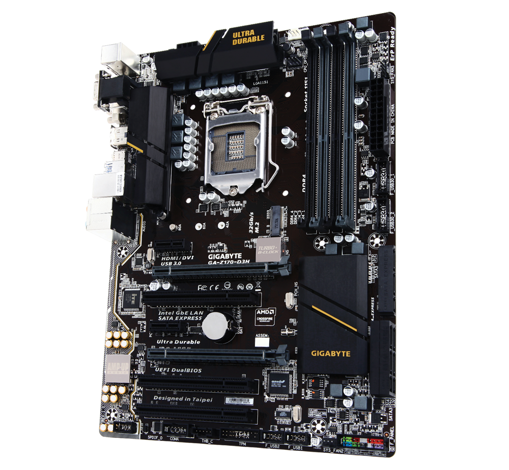

ok, here's one mobo i've been looking for some time now.
if you can check the picture, do you think that s-tdm cable is long enough if you consider connecting 3 cards.
from pci slot 1 to pci slot 2 is quite a big gap. :)
My STDM Cable spanned across an empty PCI-e 16X.
If its tight you can get an adapter that adds another 2 inches.
Its like a MIDI Coupler.
Posts: 6690
You will have to do the cable yourself I guess, it seems to big of a gap. But doing a cable is extremely easy, just a couple of minutes and you're done, as long as you can get the elements you need in your place.

thanks for all the tips.
was just getting mobo yesterday (gigabyte - GA-Z170-D3H) and s-tdm cable will be long enough for connecting 3 cards.
