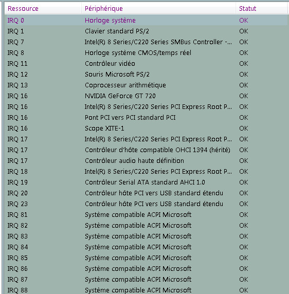

I went to check if I could disable some USB's. But Xite doesn't share any irq with any usb. I disabled several usb's and kept only usb's I must keep. That didn't change nothing on the Xite irq : they are exactly the same :
And I find Xite share its irq (IRQ 16) with a lot of things, like the graphic card ! But there is no way to change that ! So disabling usb's, in my case, seems to have no effect. I'll check, anyway, if there is benefit but I'm affraid it will change nothing.

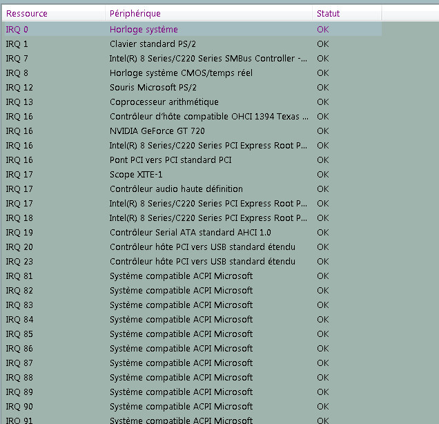

Yes ! That's exactly what I just did : I exchange my 2 pcie cards : Xite & firewire controler for my powercore.
I hope the powercore will still work a well as it was.. And now, I need a lot of time to be sure it's better.

I didn't had to wait that much ! Scope crashed after saving 3 mn after loading a project ! All I did : disabling 75% of usb's + changing Xite pcie card slot are useless !
So... It's not usb's, pcie bus doesn't change nothing and Xite irq had changed after moving it in another pcie slot. Then... What ? Why is there so people here who never have that kind of issue and other, like me, who have it ??
