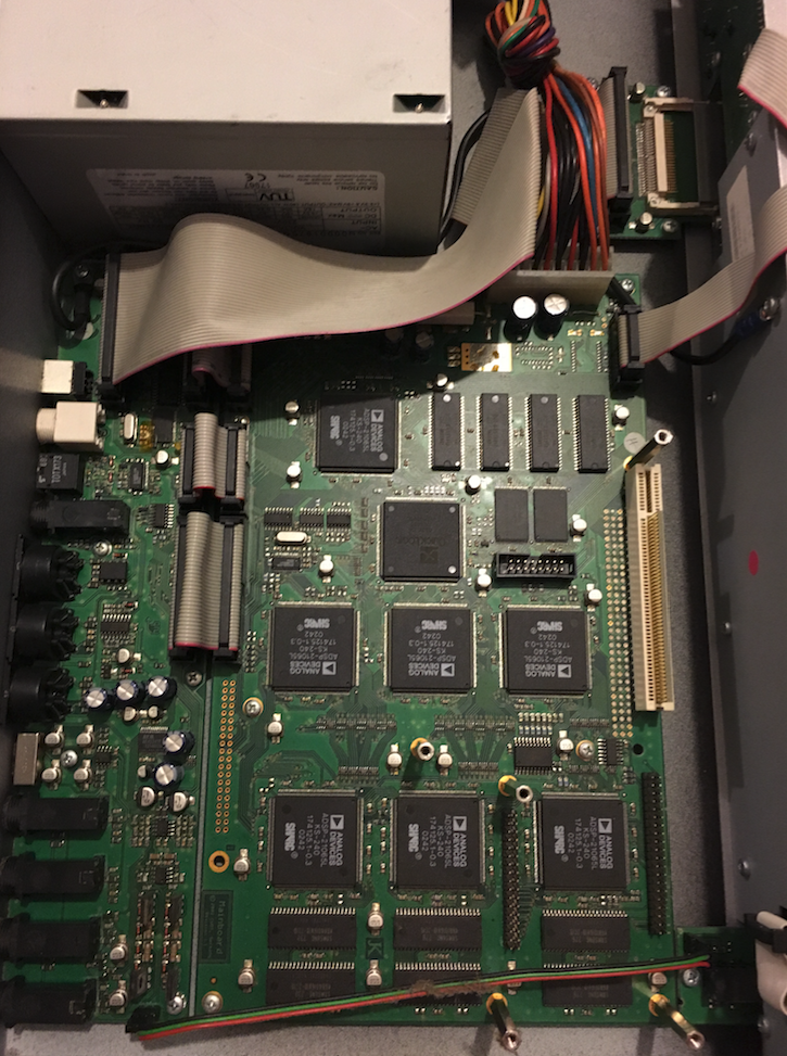

Sorry but I don't see any hard drive.
Here are the pics of Noah Ex internal ( both motherboard and expansion board) can you tell me where it should be?
Thanks again.

Posts: 23414
Re: Loading performance hang.
ooops!
i guess it's MY memory that's faulty.
really, i was just grasping at straws.

Is there a compact flash card in there? They're basically the same as an IDE hard drive. They should never die if they're the expensive industrial ones...

Oh, Sonic Core does not deal with Creamware stuff. I don't think they have the diagrams/schematics...
-Tom
Posts: 23414
-or parts....
you can PM jhulk. he has a shop....

Well, you don't have some of the parts... probably the FPGAs or the code for them. If those die, the unit is done. Most of the chips are in production...
And it would cost a fortune to fix something that's not worth a lot these days.
