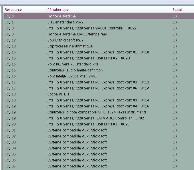

Here are irqs, apparently the Xite is alone on 18.
Sorry, it's in french -> périphérique = devices ; ressource = ressource...... Ok = ok ! :D
On my ancient pc, the xite shared the graphic card + something else like usb, don't remember well but there was no noise and hyperthreading was on. Yes, I know, it doesn't mean nothing...

Strange ! By looking at irqs I notice that "contrôleur audio haute definition" (High Definition Audio Controller) is there and I deactivated it in the bios... I go to check that...
Re: Discrete crackles
The high definition audio controller IS unable in the bios ! How is it possible to have it in the irqs ?? :-?
I can see it in the device manager too ! :evil:
What is one suppose to do to remove it ? Desoldering its components on the mobo ?

If you have an HDMI video connector or ADAT output on the board, that may show up as a separate Audio device.
Disable in Windows Device Manager (Right-Click on the device in the list, and you'll find the drop-down menu to disable in there)
Jksuperstar'> you must be right. And only the hdmi audio is not deactivable and I need the video outputs.
I disabled it in the device manager but the irq 16 remains to it... Anyway, it won't ask any interuption anymore, right ?

HD audio isn't a problem.
