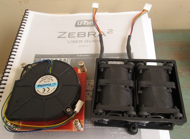

FWIW I run my CPUs @ 4.2GHz since it's a 1U design.
These parts below have to keep things @ 53 C.
Other folks like scientific water cooled nitrogen injected stuff, I am a meat and potatoes guy,
keep it simple and cheap ankyuverymush.
