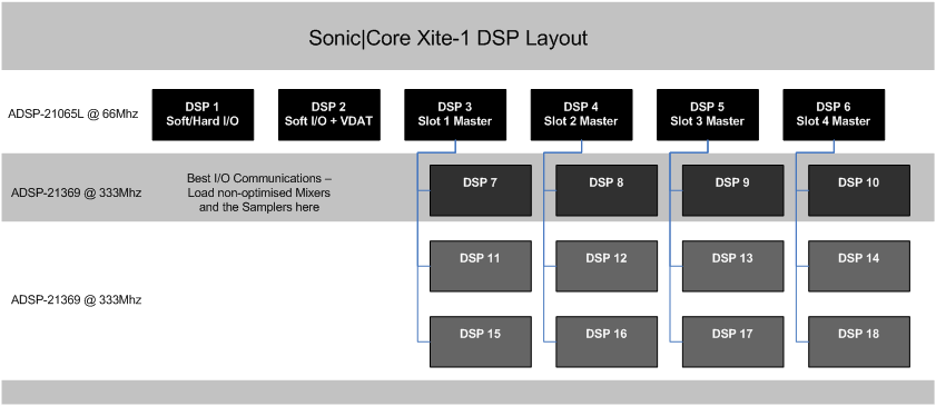

The only tweaks I know of that might be good to at least be aware of are knowing about DSP placement and the differences between the 18 dsp's.
All though it is one of the things I'd prefer not to have to think about, in some situations it may be necessary.

The ASIO actually happens through DSPs 1 & 2 (all hardware and software I/O is connected to these), and DSPs 7-10 have the most communication (SAT) to those I/O DSPs.
So by placing whatever is connected to I/O on DSPs 7-10, you can avoid the SAT errors.
DSP 1 & 2 are the actual ASIO and Hardware I/O's.

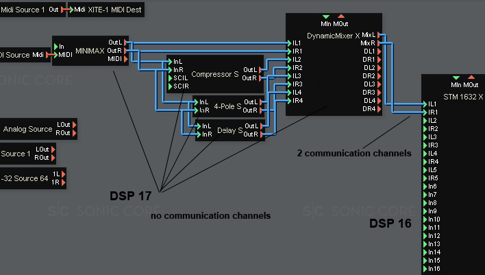

Does it mean in the example here :
http://www.hitfoundry.com/issue_22/dsp_mast.htm
that there is a benefit to use the dynamic mixer like in the 2° image ?
If yes, why the dynamic mixer doesn't need 6 communication channels at its input (simply like the STM) ?
Or there is something I miss..?.. I would have been sure that the second image is louder for dsps..(more device -> more dsp ressource) :-?
Re: XITE/SCOPE - tweaks?
Because in that example, the dynamic mixer is on the same DSP as the minimax and effects. So all communication happens on the same chip, except for the two channels output from the dynamic mixer. That is John's point in the article...you can use small stem mixers in these situations to save on the communication channel use to the big mixer, and also avoid phasing issues caused by delays in communication from dsp to dsp.
I would also add that DSP 7-10 have more SAT routing connections to each other, and make them ideal for use with mixers. All of the STM...X mixers are optimized by being distributed on these DSPs.

I guess it's more for avoiding phase issue than dsp saving. Anyway, 3 parallel fx is not a very often use for me...

This was some advice I copy+pasted from somewhere:
>DSPs 1 and 2 are for the IO communication: ASIO and Wave are placed here.
>Hardware IOs are always on DSP 1.
>DSPs 3, 4, 5, 6 are for the communication with the 4 Slots.
>Each Slot contains 3 new Sharc DSPs with the power of 6 old sharcs each.
>Also every new Sharc DSP has 32 MB RAM.
>DSPs 1,2,3,4,5,6 are old Sharcs.
The most important DSPs are 7,8,9,10. They have most communication channels to the IO DSPs.
The STM 1632 is placed on DSP 18 in the Default-Project.
It should be better placed on DSP 7, 8, 9 or 10.
Same for Micromixer and Dynamic Mixer. The bigger mixers have their own placement,
which cannot be changed.
At the moment the user cannot place devices to one slot, internally it is possible.
The 4 Slots:
Slot 1: DSP 7, 15, 11
Slot 2: DSP 8, 12, 16
Slot 3: DSP 9, 17, 13
Slot 4: DSP 10, 14, 18
The DSP display should have a special view to make this visable.
DSP Placement:
It´s always good to place a device on one new DSP.
If you need e.g. more voices for Minimax, it´s better to place it on
its own Slot and than increase the number of voices.
In //ScopeXITE/Projects/Examples is the Project synths.pro,
where every synth has its own new DSP. In most cases the distribution you have chosen
will be loaded next time within the Project, but not always.
Better use only the new DSPs for placement 7 to 18 and if possible 7, 8, 9, 10.
For VDAT you need to use DSP 2 only.
If you help XITE to spread DSP power equally and mostly separated
to single DSPs if possible, you will get the best results.
Also attached a GIF with a description of the DSP allocation.
