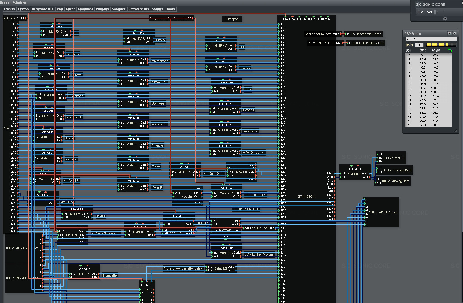

I made a huge Xite project. So huge that I couldn't put anymore device. - I kept my 3 PCI boards when I bought an Xite-1 for all the i/o and linked Xite & PCI via ADAT i/o.- I had the idea to use my PCI board for the three master verbs of my huge project.
It was an amazing idea : now, I don't know when I'll get a Scope message saying "stop ! No more connexion ... gnah gnah gnah...". I can go much higher on the dsp meter than ever.
So.. If you kept your pci boards like me for i/o, have a try ! It's incredible ! Reverbs devour dsp power !
Huge project.jpg (551.64 KiB) Viewed 5390 times
Merci de votre attention.

I can't resist showcases...
very carefully tuned Xite-1 (sdk) Project in 96kHz. 9 (custom) sdram reverbs, 102 instrument synthesized voices, 17 chorus

Waow !
Yes sdram reverbs are good for xite ! But puting the reverbs in the PCIs is even better !
But which Scope version are you using ? Isn't it SDK ?
Did you keep your PCI boards ?

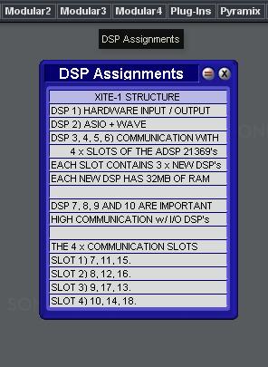

Dsp 10 ?? I thought it's SC who made dsp 2 for asio ! I Never heard dsp 1 about asio... The dsp 1 is for hardware i/o, isn't it ??
The bible :
DSP assignment.JPG (30.67 KiB) Viewed 5326 times

i don't want to confuse you. I put Vdat in dsp 2.
I do tests with different positioning of the asio and i have reached the conclusion that it allows more channels in 10.
Perhaps it was something else...
My (practical) understanding of the dsp structure of the xite-1 is as follows:
1-6 old sharcs. VDAT works only on dsp 2.
7-18 new sharcs. That's it.
7-11 have better (probably) communication with asio.
I only use the new dsps.
Connections inside a dsp doesn't consume any communication. Connections between dsps cost communication.
My old pc groans and cough. I believe it has fulfilled the purpose of its existence. :D
Keep on the great work! :)
