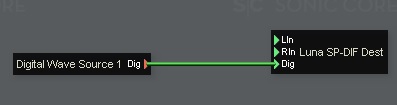

Posts: 5055
Re: Spdif connection
Heres the only legal (no 'pad' errors) connection I could find.....
dig-to-spdif
dig-to-spdif
Basically, if you don't have a surround output capable soundcard like a soundblaster for games and DVD's, well, you do now if you have a Scope PCI card and a surround system with spdif (coax) input !
