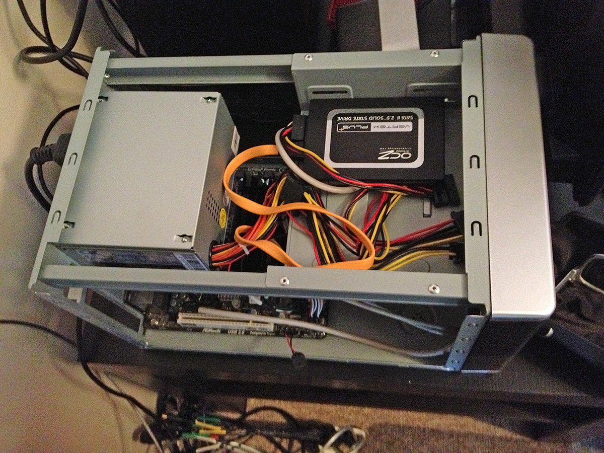

A friend of mine is using an AsRock as2700 itx motherboard, into a ITX computer case, that is very good for a Scope 4/6DSP.
It features a single PCI.
With Windows XP pro, an SSD 60GB, 4 GB of ram, it reacts like a standalone synth. It starts up in 10 seconds!
You can set your project starting with OS, so a monitor isn't really needed if U use for example always the same midi mapped synth.
Otherwise, you can use Teamwiever or Real VNC to modify your project from any other computer/ipad.
A silent or even fanless PSU is advised.

- Asrock-ad2700-itx.jpg (491.5 KiB) Viewed 5135 times

Yes, I would like exactly something like this.
But the most of these ITX motherboards have PCIe only. Does it fit Pulsar I card or do I need the pure old PCI only?
P.

Re: Small motherboard for Pulsar I based synth?
You need a PCI slot. They are not compatible. You can get converter cards, but that will take extra space, cost extra money and it may or may not work well. Go for at true PCI slot. Avoid socket 1155 motherboards. This one 'might' be a perfect match: http://www.idealo.de/preisvergleich/Off ... abyte.html
I have not tried it, but the thought has struck me many times.
So the AsRock as2700 itx motherboard is YOUR card, it has an Atom dual core inside, without fan (so totally silent), that provides the right CPU power to manage your Scope OS.
The slot is PCI legacy.
