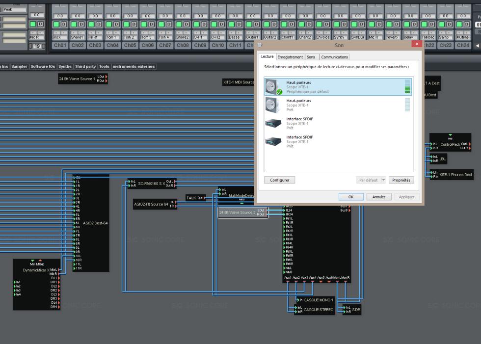

ok, after some research, i just found a solution to have the "24 bit wave source" module with stereo:
I have to load first a wave source (16bit or 24bit, doesn't matter), and only after the 24bit wave source (then called 24 bit wave source 2).
After that, I have to change the wave device default in windows (the 2nd one was default, i had to change it for the 1st one). If i don't change it, foobar is playing well, but not flash.
At least, i can remove the first wave module from Scope, and 24 bit wave source 2 is ok, with stereo.
I don't know why i have to do that, can somebody confirm it with a test please ?
If i let the default windows wave device (the 2nd one), and load only the 24 bit wave source module in Scope as usual without loading before a 1st wave source module, the 24 bit wave source only plays sound in mono (but the 16 bit wave source is working well without any tweak).
